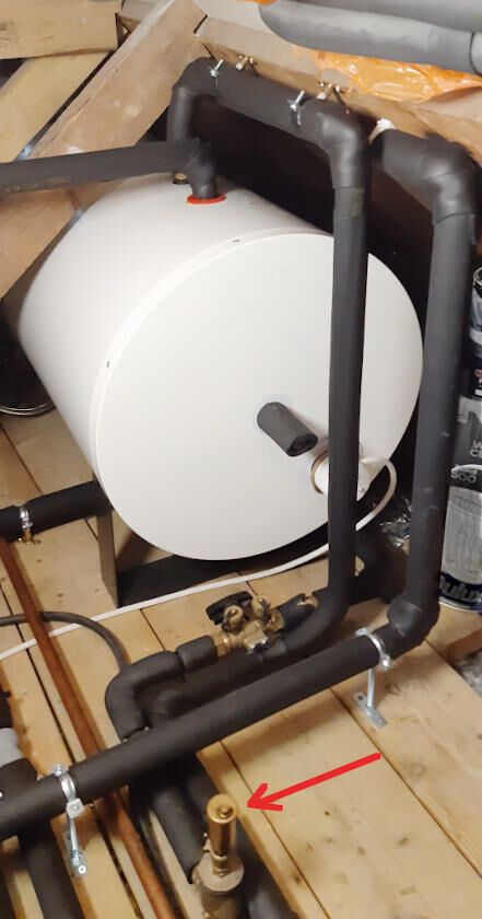

Merely having air-release valves present isn't enough.
They also need to be placed at the highest points in the pipework because that's where the air will collect.
Look at this photo of a cylinder fitted sideways on in a cramped attic space:
Amat2
Pirate Rich
(@pirate-rich)
Posts: 31
Exactly what I said in the video, and that is one of the worst AAVs in the market, so they can expect leaks in the future.

Posts: 5756
Your energy: 115 kWh
Posted by: @transparent
Even that may not be enough.  Air can still collect, it seems, at local high points eg tall radiators, which will need to be manually bled unless also fitted with an an ARV.  Despite having an ARV at what is otherwise the highest point, I have 2 tall radiators one of which had to be bled every other day for a month and one of which I had to bleed recently.
