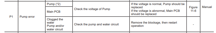

Im not a Grant expert but the Grant R32 manual says the following - it this the error?
I wonder how it detects this error.  One would think it was the flow meter but it could be temperature sensors.  You seem to have checked the obvious, the other things I can think of are: Is there a fine mesh filter somewhere (I have one on my Vaillant system that wasnt obvious until the installer pointed it out), is there a real time readout of flow rate which could confirm.  Are there any other real time diagnostics that might tell you whats going on?
