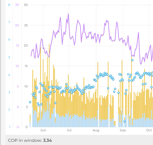

There was a software update sometime in August that made my hot water COP alot better. Literally a jump like 1.5 extra.

@kevh good question. No way of knowing afaik. I only found out because I was keeping a close eye trying to work out my issue and the ramp up behaviour significantly changed.
Look at my MID graph for hot water COP after end of August, it's very obvious on the DHW. Keep in mind i run a very hot 55C 300L water charge
