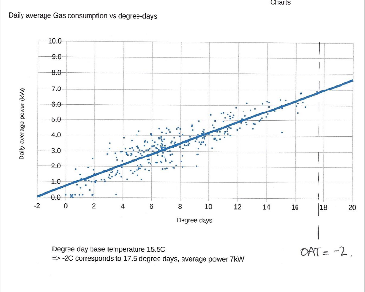

In this case you need to use average OAT and energy supplied to the house (as opposed to energy consumed) to do the calculation.  You then get the loss at the OAT corresponding to the average.  The problem with a 3 hr window is many houses take 12 hours or more fully to respond so it may well not be representative unless the preceding conditions were very constant.
Unfortunately although its conceptually very simple, practically its not so simple because the outdoor conditions keep changing, unless of course you have a house in a lab or you get one of these days when the temp is stable for 24hrs, which does occasionally happen.
The more robust way is to plot heat supplied to the house vs average OAT like this (the plot used degree days rather than average OAT but the concept is similar).  You can see from the scatter that taking even a single day in isolation can lead to a considerable error.  This was from my gas boiler and is basically how I sized my heat pump.  Installers were then told that they had to make their GIGO calculations fit the facts otherwise I would look elsewhere (I didn't quite put it that bluntly but this was the message).
