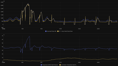

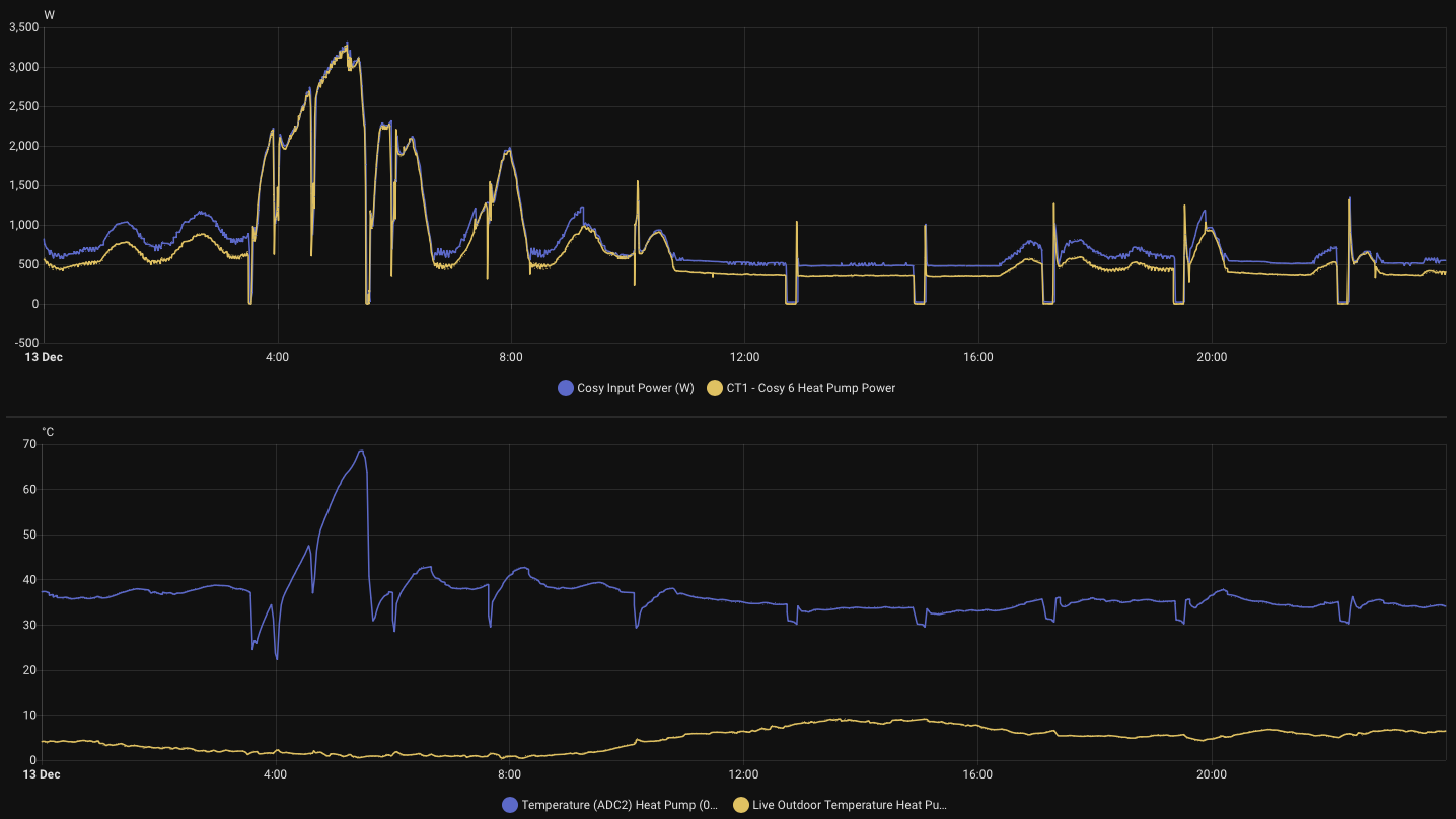

I just found this forum after watching the YouTube vids for a while, and have been on the Octopus and Facebook groups for a while. I have been playing around with the settings I can access for a while, initially tweaking the WC settings and radiator valves to get an even temp across the house. Whilst this worked for the last 6 months I found the high noise of the Cosy 6 whenever it came on to be annoying and not in-line with how the rest of the industry seems to have their heat pump operate.
For background, I run my system with a constant 21degC target across the house and a 50-60 degC DHW temp that runs at night.
I have over the last week been running my system with a constant 23 degC target temp with the WC settings at the minimum they will go (30/50). I find that even with these settings the house never goes below 21 and often sits at 21.5. On the colder days (below 5) I see the oscillation in the power and flow temp which I thought was an underdamped control loop but reading this thread it seems there is a temperature element to flow temp.
As others have mentioned you cannot change the flow temps below 30/50 but you can change the outdoor temps for the curve to whatever you like. Normally warm weather is 12 and cold weather is -10 degC. I currently have it at 13/-10 but am going to try -20 to get the flow temp to drop a bit more when its colder outside as I am getting overheating.
I have also found that the Power Input recorded in the Cosy app and from the API is a higher than what my Shelly EM-50 records when the heat pump modulates down. I have put this down to Octopus not recording Active power and instead Apparent Power. The kWh consumption readings can be 10 kWh from the Shelly and 12 kWh from the Cosy, which has a very different COP assuming the heat output is correct.
Below picture is from a few days ago and you can see that at the lower outdoor temps the compressor starts to fluctuate.

@harrisonc mine has level 3 MID monitoring and you can see this power ramping. It's not completely weather comp control, there is a thermostatic element.
Basically the cosy should be thought of in terms of running cost and not COP.

@swwils I am going to have to try putting the primary cosy pod in the airing cupboard to make it think the house is warmer than it is and see if the ramping flattens.
I have enough battery to cover the usage on a cold day, so I am just looking at efficiency, but can believe they designed the control to work best with the limited hours in each slot of the Cosy tariff.
I can't complain that my yearly bill is £1,100 for home, heating and 20,000 miles on the car.
Did you add the Level 3 MID yourself, and assuming you're the only Cosy 9 on HPM do you find the heat output reported by the API to be similar to that of the MID?
