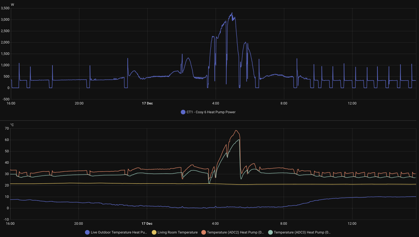

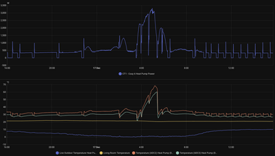

@andrewj I set the weather compensation curve to Hot Weather being 8 degrees and Cold Weather being -15 degrees last night, with flow temps still at the minimums of 30/50 and had good results. Last 24 hours we have had temps from 10 down to just below 0 and seemed to work well with very little overshooting. House has levelled off nicely at 21 as well.
Red line is flow temp, green line is return.
