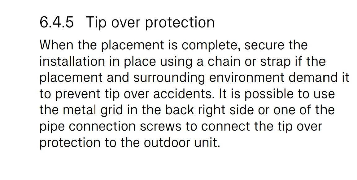

@editor the aira installation manual calls for it but leaves it suitably vague about how to achieve it. I'd rather have something than not, although I think the risk of it tipping over given the weight is slim at best!

@gmuzz, thanks for sharing (and welcome to the forums). After posting this today, I got a message from Aira's Group Service Operations Director, who's asked if I could share your details with him because while the heat pumps are supposed to be secured, he feels it should have been done differently and he'd like to get this rectified for you. Please let me know if I can share your email address with him.

@editor that's fine. Thanks
