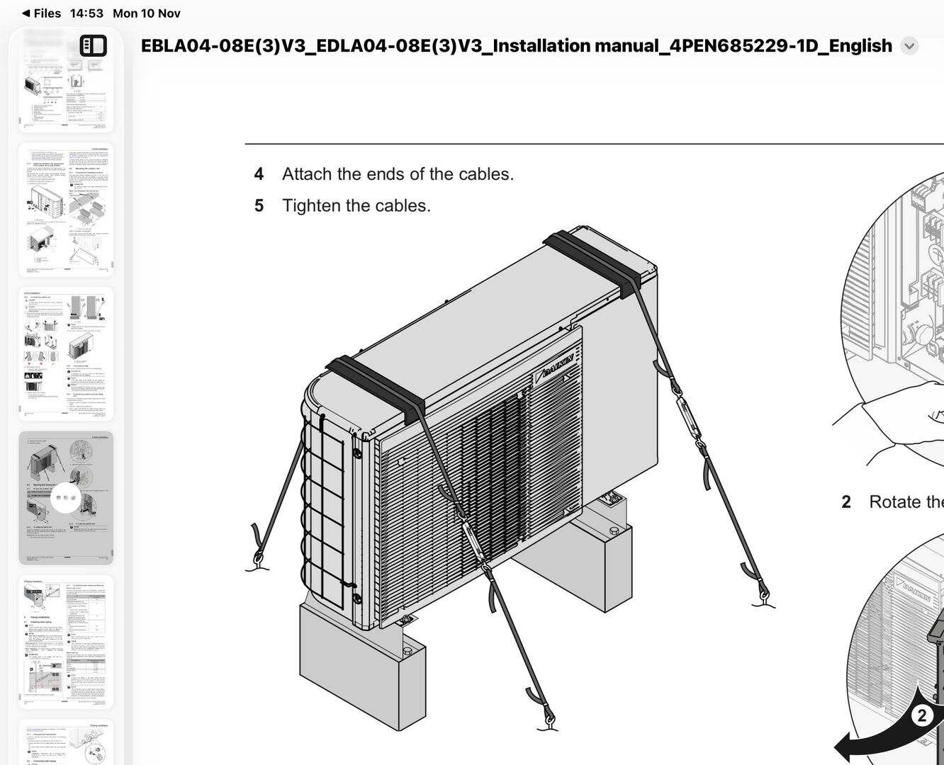

@editor I have seen installation notes for Daikin (and I think Vaillant) ASHP’s whereby (presumably for H&S reasons) such retaining fasteners are recommended. Regards, Toodles.
(@mikeh)
Posts: 55
@editor it's in the installation manual that they are chained to the wall to mitigate the risk of them tipping forward. My early install isn't chained, and I happy about that. Some people held the installers too the letter of the guidelines until they chained them up. personal the risk look very low on the single fan units. More of a point with the twin fan units I guess. Although they should provide mounting points on the back of the unit, if they want them chained. This is is an unsightly afterthought.
Posts: 5045
Your energy: 74 kWh
Really interesting @mikeh and @toodles. I'd never seen a ASHP unit chained back before. I guess it makes sense if they're 'lanky' and top heavy.
Posts: 3099
Your energy: 33 kWh
@mikeh And must make for awkwardness during servicing that requires access to the cabinet itself. This is not necessarily a problem for certain service engineers I have experienced of course 😉. I think that if there is any risk of toppling, the retainers should not need to be removed for servicing - unless of course, service engineers are two-a-penny and expendible. Regards, Toodles.

@editor Here is how Daikin recommend for one method of stabilisation; this is from the Daikin Installation Manual. Toodles.
IMG 1387
Funny
Posts: 3099
Your energy: 33 kWh
Though, in itself, I can see it representing a trip hazard! Toodles.
