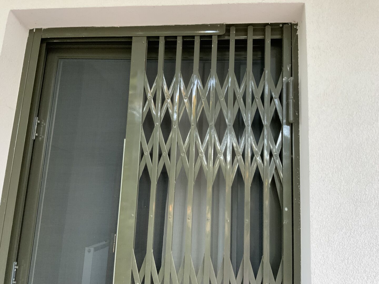

4. If you are not surrounded by buildings, chances are the night breeze will help (large, uninsulated buildings and paved roads/yards emit at night all the heat they absorbed during the day - just touching them is sheer despair…). Perforated shutters are not enough to make a difference unless the Δt is substantial. You are better off with screens that allow air circulation and keep the mosquitos out. To keep burglars out you may install removable bars….
(example attached)
