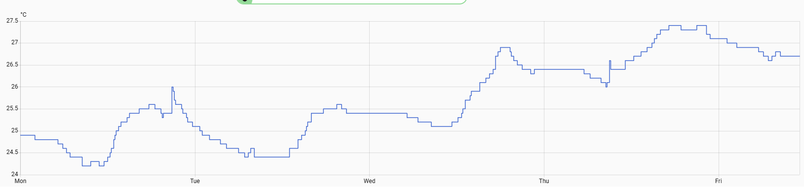

IAT in the 'sunroom' (the clue is in the name).  This has the fancoil in one half of the room, the sensor is in the other half.  The very slow reaction time of the house is very evident in these plots.

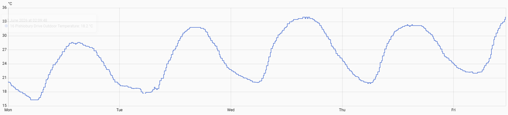

OAT on a north facing shaded wall

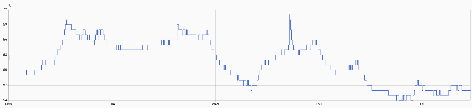

Humidity ditto.  The drop towards the end is because I started running the dehumidifier on half power 24x7, rather than full power overnight.

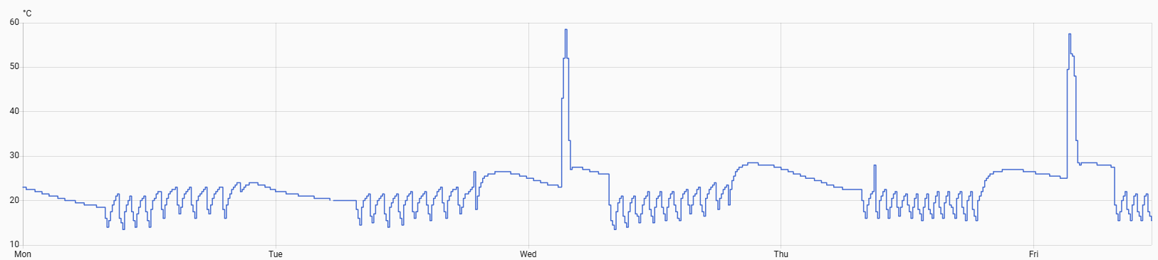

FT, obviously including some DHW cycles.  The Heat pump is on 7.30am-7pm only.  The change in dehumidifier operating mode is also manifested here.  Before running it constantly the FT used to creep up during the day, because the heat pump was adjusting to an in creasing humidity by increasing its target FT.  On Thursday you can see that this did not occur.

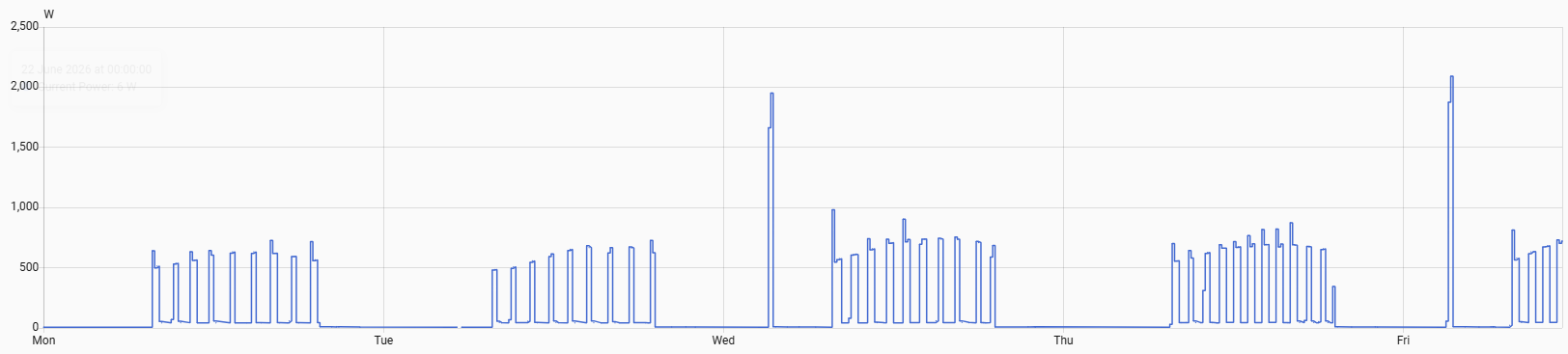

Power consumption

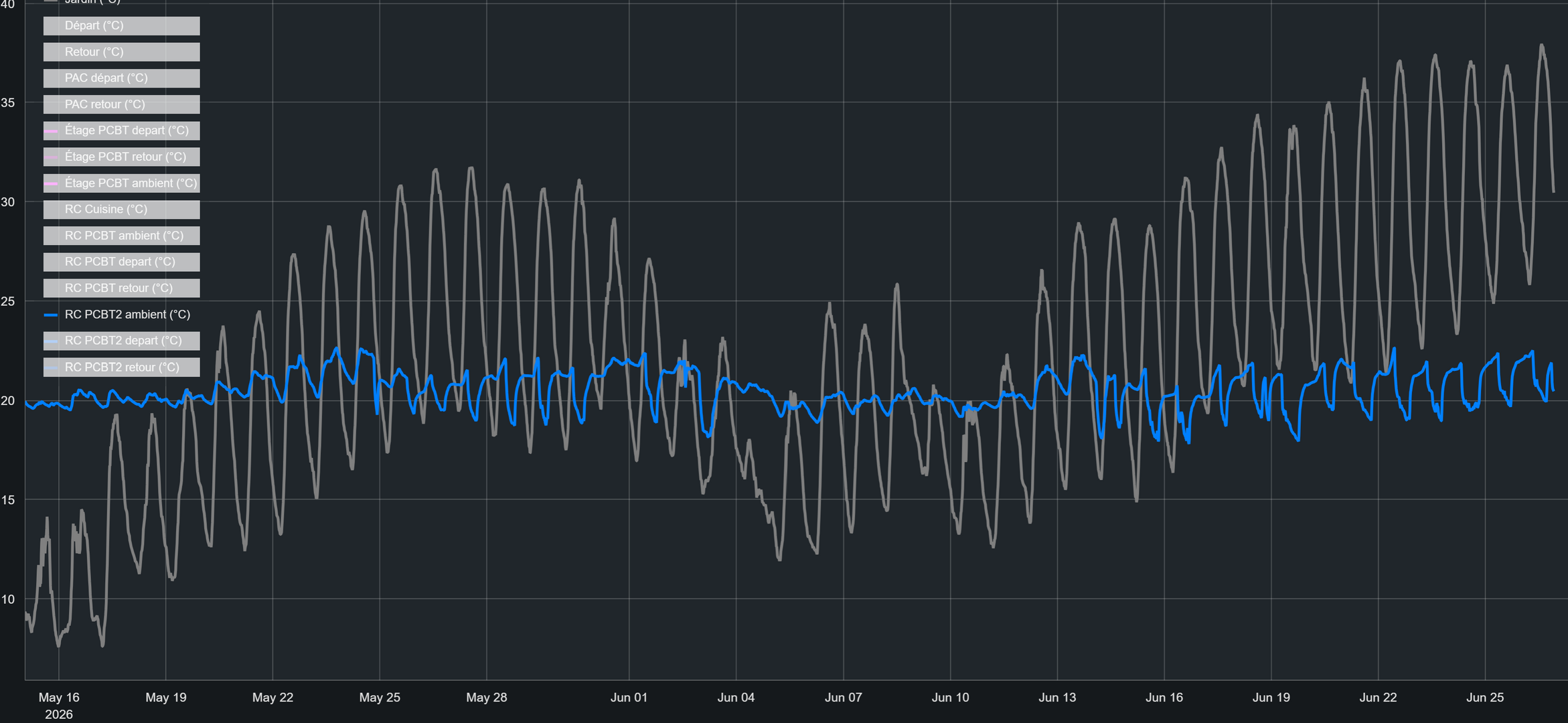

Results:
Strategy:
** When night time temperatures are cool (ie, minimum around 15-16°C) but day temperatures are hot (>30°C).
At night, open windows. Louvred shutters and perforated rolling shutters remain closed, these let air through without allowing in thieves or cats. Push "Auto ventilation" button in Home Assistant. 8000 m3/h fan in the corridor turns on if indoor temperature > outdoor temperature. This cools the thermal mass during the night. When morning comes, close windows. This keeps the whole house around 20°C during the whole day.
** When night time temperatures are above comfort level
As shown on the right side of the above plot, it is not possible to cool the house with outdoors air when outdoors air is hotter than the house. Therefore, close all windows and turn on portable second hand aircon units. But only if electricity is free obviously. They're on smartplugs, controlled by Home Assistant.

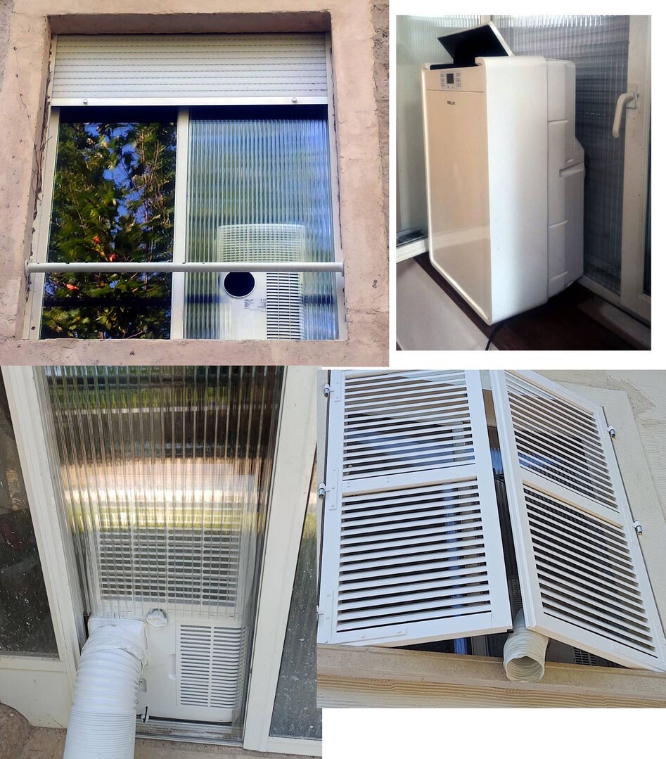

You're using it wrong 👌
Okay, it was designed to be used in a way that makes it useless, but that doesn't mean you have to!
Portable AC units have two airflow paths: one over the evaporator, which sucks air from the room, cools it, and blows it back in the room. And another path over the condenser, which sucks in air, heats it, and blows it out through the pipe.
For optimum efficiency, the condenser is placed outside and only handles outside air. The evaporator is placed inside the room and only handles indoors air.
If all you have is a mobile aircon unit, you can do the same by mounting it like so:
Clim de fenêtre
It isn't necessary to make it airtight. All that's needed is to plug the window with an alveolate plexiglas panel with a hole in it, put the AC unit in front of it, and push the button.

Hmm I should have explained it better...
Problem with these devices: they have only one pipe. Thus they suck in already conditioned air out of the room, and blow it out. Air sucked out of the room then will be replaced with hot humid outside air that enters wherever it can. So these devices tend to only cool one side of the room, while hot air that is sucked in actually warms the other side of the room, and temperature climbs immediately after switching them off. Humidity is really an issue because a significant fraction of the power is used to dehumidify, so every bit of outside humidity entering means more power is wasted, and obviously using it with the window half open means a huge amount of humidity gets in all the time.
The idea is :
The window should be closed with insulating material with an opening in it, the result being reasonably airtight except the opening.
The air inlet for the condenser, which is the bottom grille at the back on the device, should be placed in front of this opening.
This way, the evaporator fan sucks in outside air directly through the opening, this air runs on the evaporator and is blown back outside.
This does not create a low pressure zone in the room, so outside air is not sucked into the room, which massively boosts the performance of the device. Used as intended, it barely cools the room to 27°C, it's a total waste of power. With this simple and dirt cheap mod, it becomes a real aircon, capable of cooling a 50-70m² area to 20°C while outside temperature is scorching hot.
These units are "seasonal fruits" a bit like tomatoes: you can buy them second hand in February for 150€, or in July for 5-800€ lmao. Second hand units will most likely not work (or barely work) because both heat exchangers will be completely clogged by dust. Reason is, to clean the evaporator, the device must be disassembled with the whole back plastic shell removed. Once cleaned it works like new. Fins on the heat exchanger are very fragile so the best is the vacuum cleaner brush (the one with soft hairs).

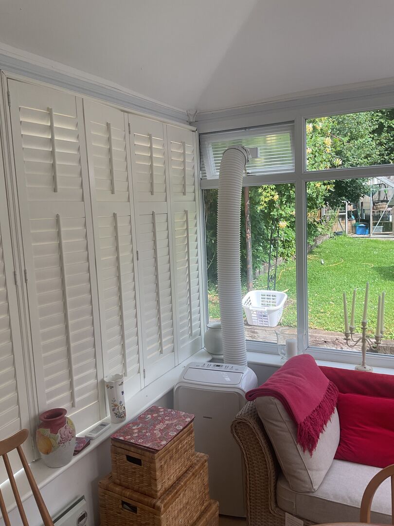

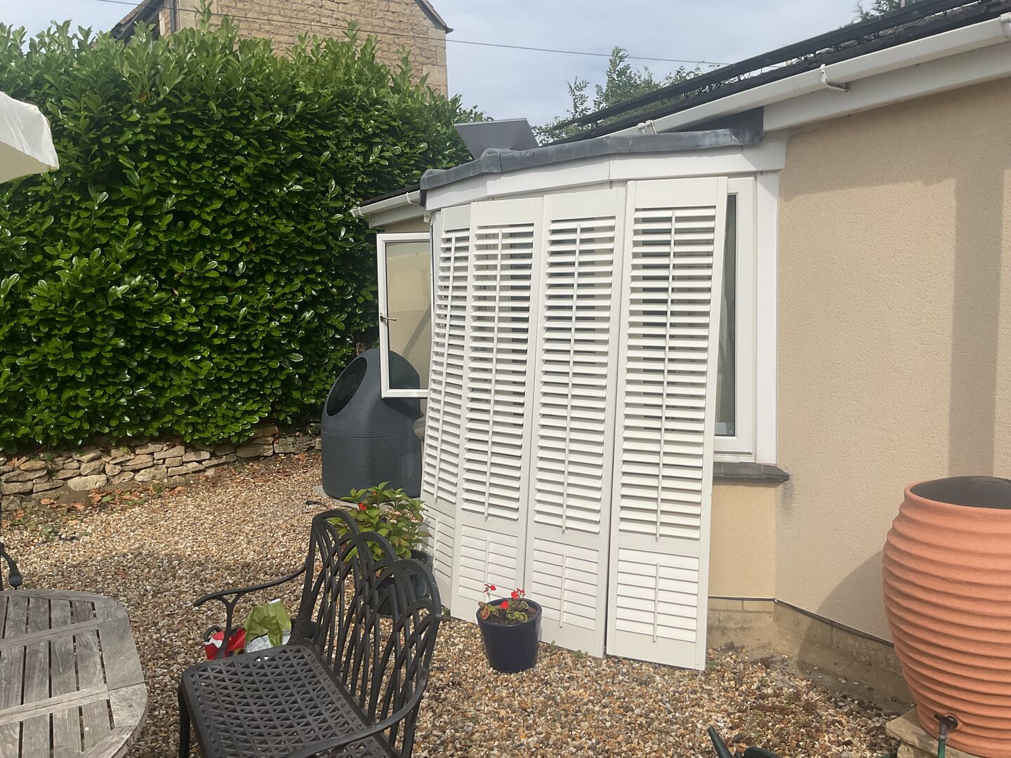

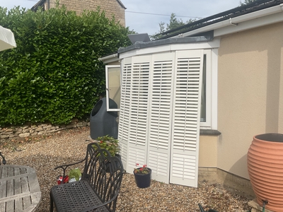

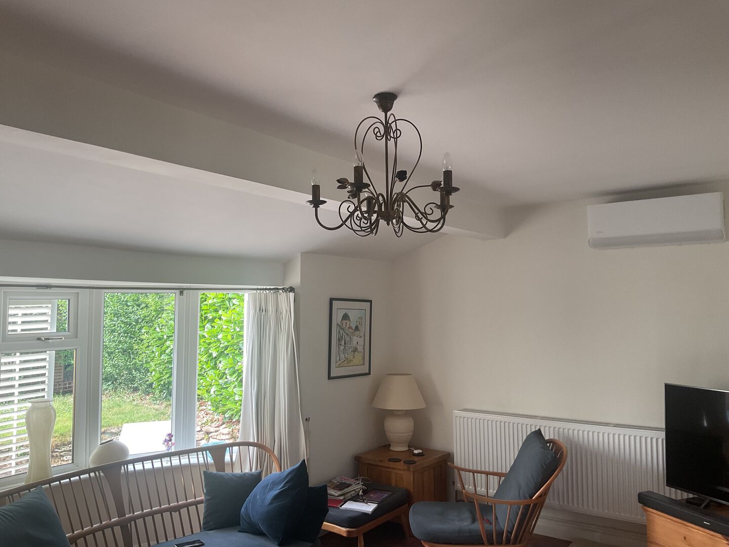

Some pics of my heat solutions…
IMG 4547
IMG 4549
IMG 4548
Bought the shutters as a job lot on eBay, stored in the garage over winter, bodged the outlet for the mobile in the conservatory and installed a Midea A2A in the lounge.
Shut the house down at 23c and open up at 23c evening.
