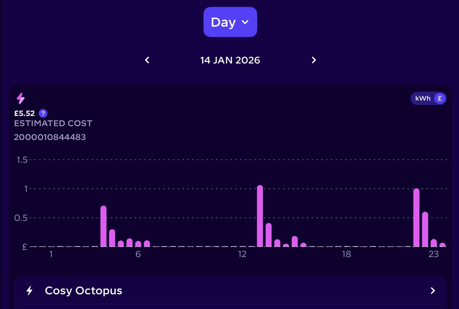

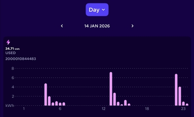

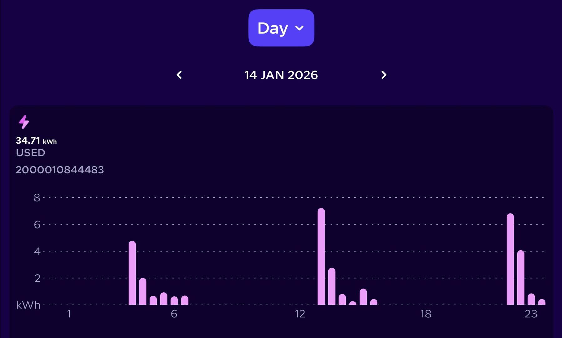

@johnnyb Here is my results for Wednesday 14th. Jan., I only draw from the grid during the 8 Cosy cheapest rate hours if possible. Solar input in January may amount to ~120 kWh and this will be consumed during those sunny intervals as the heat pump exceeds supply right now. Regards, Toodles.
This is ours and is very similar for most days.

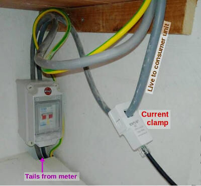

Could you post a photo of the meter and it's connection cables and/or a diagram showing us how the CT's are related to the meter?

Our Solis is single phase and we initially had the CT clamp directly connected to the inverter. Subsequently we introduced the Din-rail mountable meter that Solis supply, which is plugged via a dedicated rs 485 port on the inverter. I assume the same thing happens with the three phase one. I will post more info on the Solis inverter thread.

I have an Eastron SDM630MCT meter and I will post a photo later when I can get it off my phone. It is one from the list on the Solis page batpred linked to in the Solis inverter thread.
