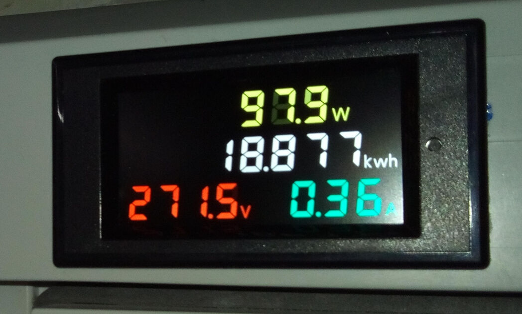

Yes, you could install a DC meter between the PV array and the Alpha. Accrel and Eastron are possible manufacturers to consider. Their products are available widely online, and cheapest from AliExpress.
To comply with submitting data on which your FIT payment is based, the meter must be MID certified (for accuracy). And it needs to keep a record of the totals, possibly aligned with time. It's no good just having a £5 watt-meter like this for example.
GenericMeter
