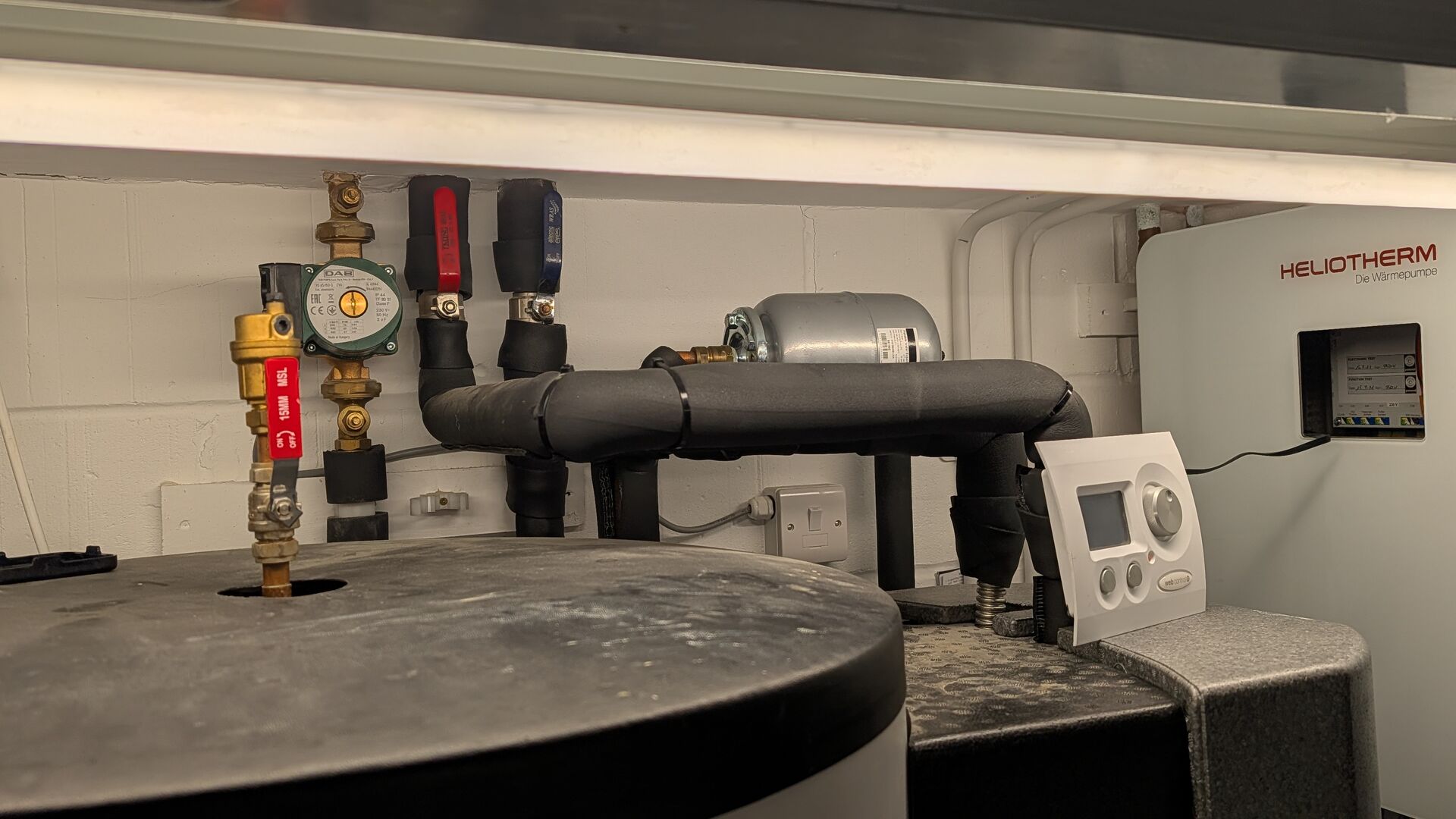

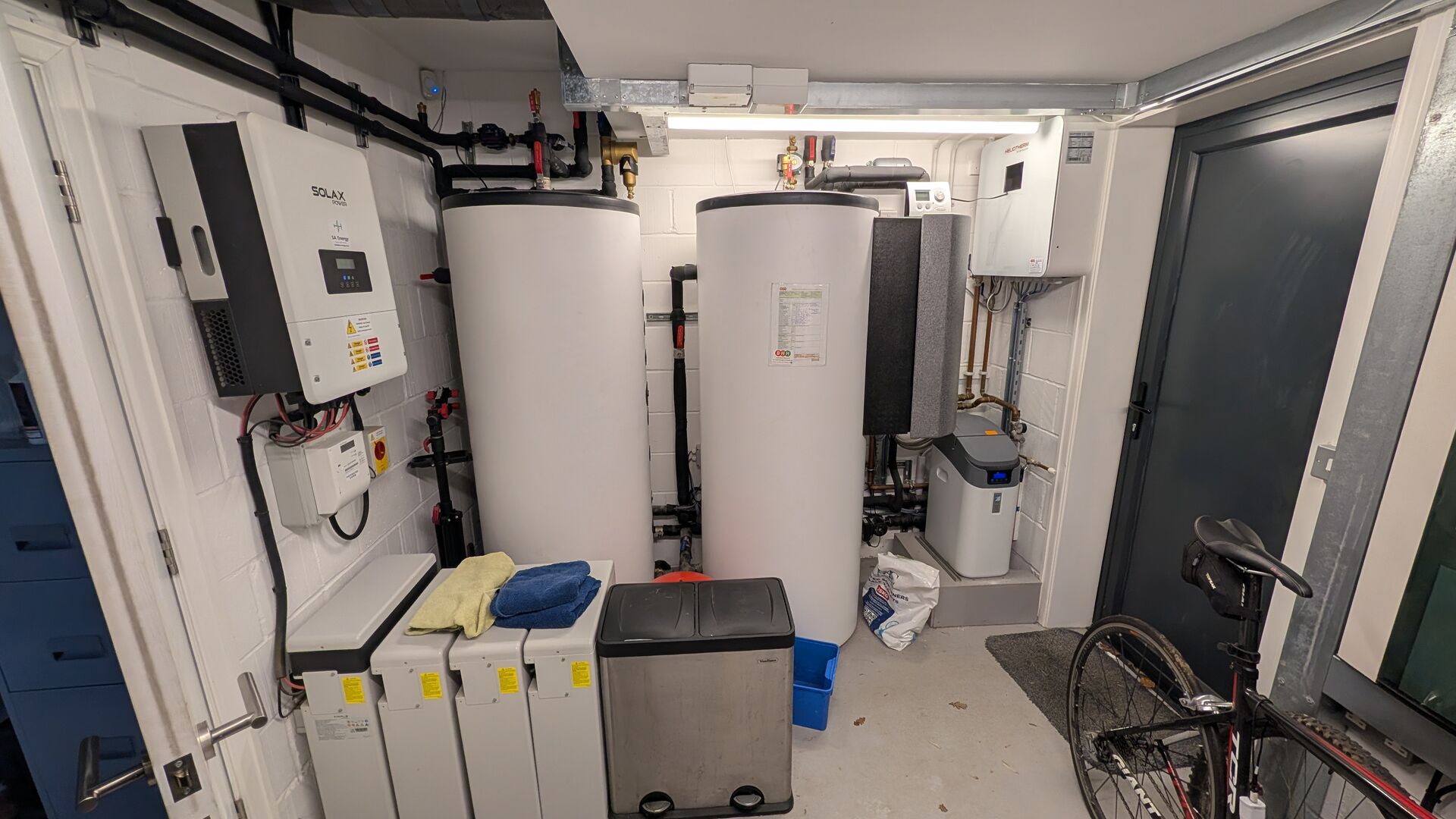

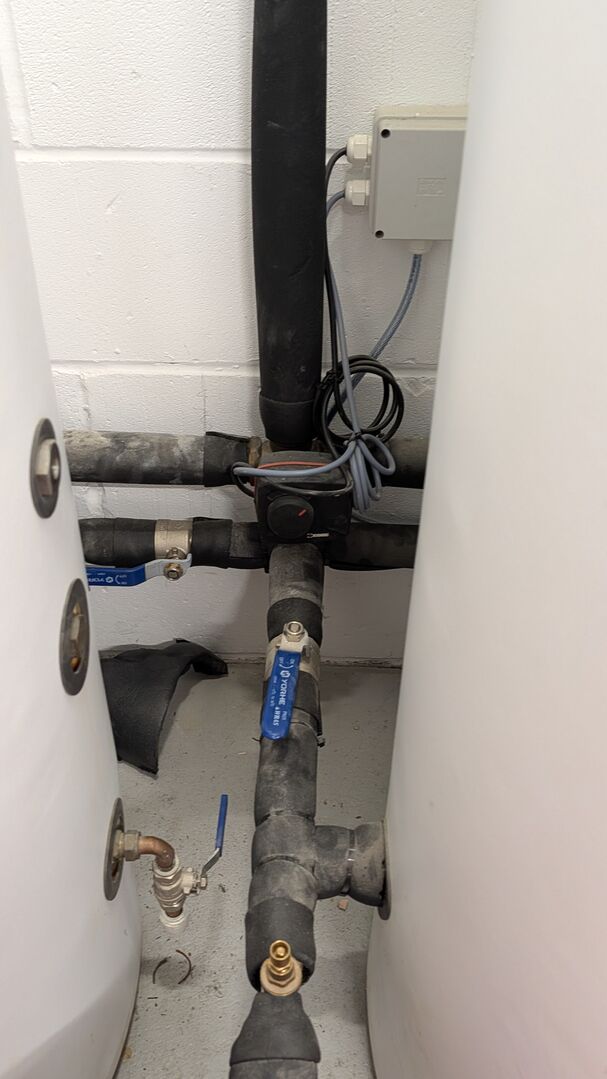

(@errmm)
Joined: 10 months ago
Posts: 12
@jamespa
Attached are a few photos I took from today.  I also have a video if that might help.
Mike
PXL 20260130 145232975
PXL 20260130 145252537
PXL 20260130 145306089
PXL 20260130 150141174
Posts: 5710
Posted by: @errmm
@jamespa
As you now have a Heliotherm engineer on the case I wont comment further.  As @mars says this is high end stuff, the suppliers need to be made to work for their money!
