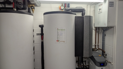

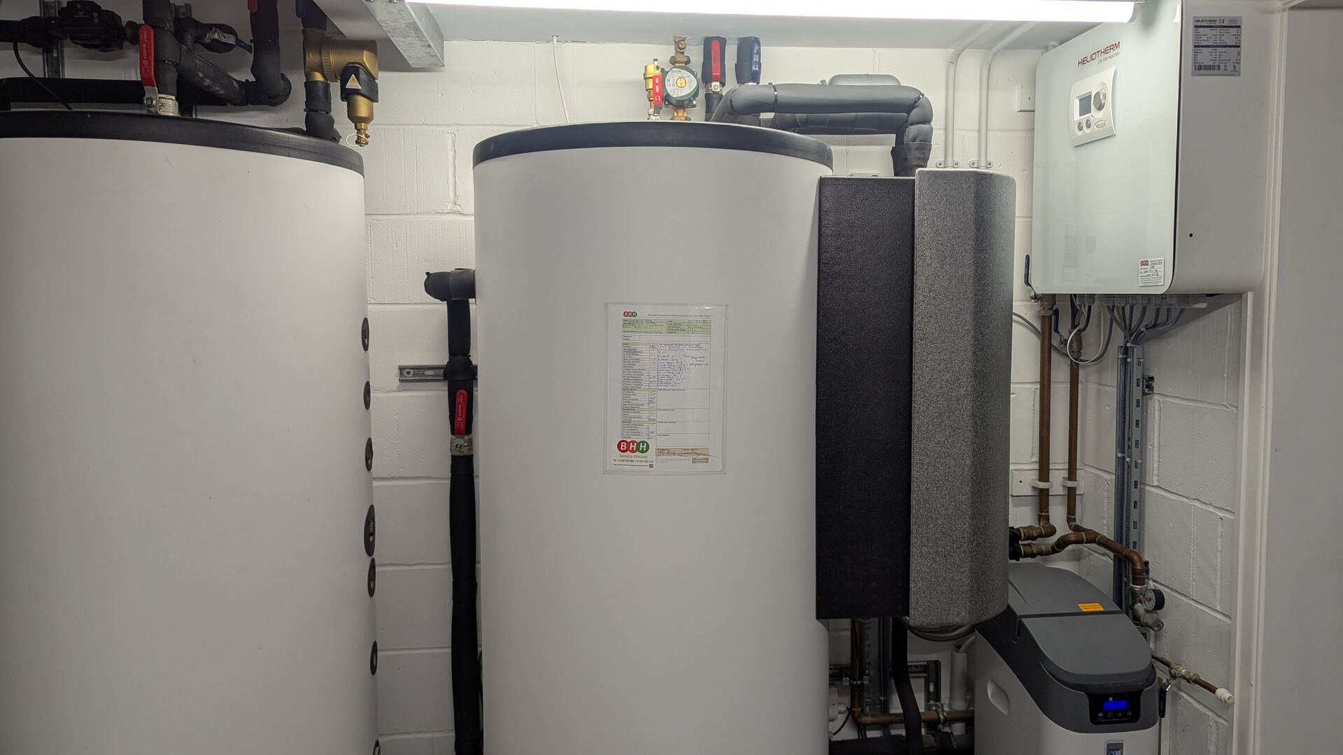

(@errmm)
Joined: 10 months ago
Posts: 12
Hi
Attached is picture of the tanks.  It's a heliotherm.
I've spoken with the installer and they mentioned flow rates on showers as well.
Mike

(@errmm)
Posts: 12
PXL 20250806 145431018
Posts: 5710
@errmm Difficult to tell from the photo what's going on, but those are at least 300l possibly 400.  Need a photo where you can see the pipework and whole tank to be sure if one is dhw and the other a buffer.

(@errmm)
Posts: 12
Hi,
The left is the buffer tank, the right is DHW.  It's right is one of these https://www.heliotherm.com/en/fresh-hot-water-system/fresh-hot-water-system.html   It says it's fresh pure hot water on demand.  So I don't don't understand that description along with a well two showers and it's luke warm....
Regarding sensor position, the person themselves is the one who said the water was lukewarm after the showers.  It's not the case that they're looking at this data.  It's me looking at it and going ok, that seems to be correctly reflecting what they are saying.  I will ask about shower habits just in case though, just to rule it out.
Mike

Posts: 5710
Posted by: @errmm
Hi,
Mike
From the website I think it's a heat store not a conventional dhw tank.  Not a good idea with an ashp and could very likely explain what is happening.
PS. I read it a second time, it is a heat store.  Interesting though that they sell it to work with an ashp.  Would need to examine the specs and operating instructions to understand how they think it should work.
