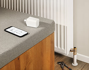

The Eve Thermo Gen 5 has arrived as one of the most refined smart radiator valves on the market, launching in late 2025 with a sleek redesign and cutting-edge features that set it apart in a crowded field.
This isn't just another gadget... it's a premium, privacy-first solution that combines Matter and Thread connectivity for seamless integration across major platforms like Apple Home, Google Home, Alexa and SmartThings, all without subscriptions, cloud dependency or data sharing.
What makes this generation truly special? The compact, tapered design with matte and glossy finishes blends effortlessly into modern homes, while the built-in LED display and touch controls allow instant manual adjustment... no app required.
The real game-changer is its near-silent operation, a massive improvement over previous models that addressed common complaints about noisy valves. Pair it with the optional Eve Thermo Control external sensor for pinpoint accuracy (measuring temperature at your bedside or across the room instead of next to a hot radiator) and you get unparalleled precision. Add in thoughtful details like automatic valve exercising to prevent sticking, year-long battery life from simple AAs and effortless installation that even DIY novices can handle in minutes: unscrew the old, screw on the new, scan a QR code and you're done.
