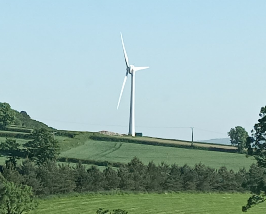

Noise nuisance was my first thought. All wind-turbines require noise specifications to be provided to the LPA when submitting the application. That's tricky because it's not just the blades and generator which could be a source of noise, but the vibration of wire stays when wind-speed just happens to be at a certain velocity.
However I think the legislation is too wide in scope.
Imagine a rural farm on raised ground with an upslope from the direction of the prevailing wind. It's a good location for a turbine. But that could be anything from a small domestic unit mounted on a 21-foot scaffold pole to a commercial turbine supplying to grid. The nearest neighbour could be well over a mile away.
These medium-sized turbines are widespread on farms across the West Country. They might generate up to 500kW.
I can't see any overlap of constraints between this sort of turbine and an ASHP at the adjacent farmhouse!
Are the civil servants thinking of a domestic turbine within a suburban garden?...
... in which case the definition of "curtilage" needs specifying.
