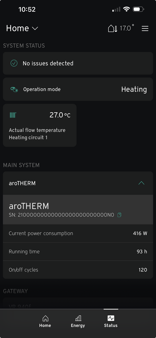

Still setting up and testing my new Vaillant.

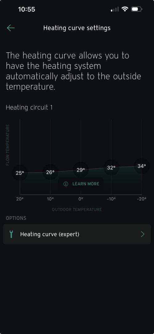

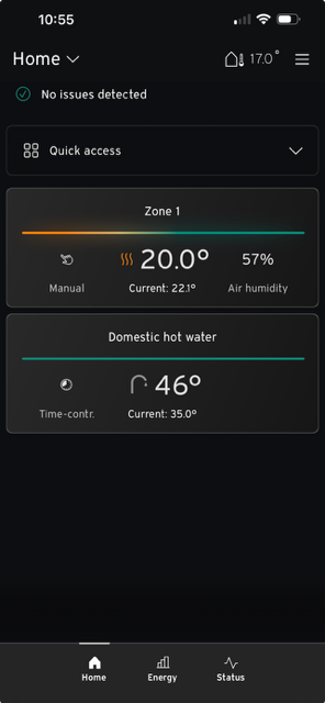

Firstly I have attached some screen prints of my set-up, could you advise if my settings correct.  I am trying to achieve:
Internal Temp: 22C
Curve: 0.2
Manual setting
24 hrs run time
Secondly.  My flow temperature is a lot higher than the target being set by the Heating Curve.  Its 17C outside at the moment so I should see a flow temp of 25C according to the curve, but the app, sensocomfort, and my temperature probes are seeing 27C.
Some addition data that may be relevant:  Typical power 400 watts consumption, compressor running at 25%. HP is cycling every 2hours (which is to be expected).

Internal Temp: 22C
Curve: 0.2
You won't be able to achieve those simultaneously unless curve 0.2 happens to be exactly the correct curve for your house.  To find the correct curve set target temp to 22 (as that is your target temperature/ and adjust curve factor slowly (no more than 0.05 per 24 hrs) until house settles at 22.   Best done a bit later in the season when demand is higher, at this time of the year there is still lots of noise on demand.
Posted by: @trebor12345
Manual setting
24 hrs run time
Settings correct for that yes.
Your pump is cycling at low demand so ft will be higher much of the time.  Also I think there is an installer setting for mine ft (in the hpui possibly) which may override.  I wouldn't get too concerned at this stage in the season.
That's a good figure, is it the 5kW pump? My 7kW bottoms out at 600W.
I am still trying to get to grips with how the Curves and set temperatures inter act with each other.  I set 20C as the base-line for all the Curves (as thats what is shown in the manual/chart.)  I was of the understanding if I increase the setting of 20C to 22C then that would give me a higher Curve, resulting in a higher flow temperature.  Have I got it right?
The 400 watts is on my 3.5 Kw HP.  I am really happy with the low running.  I suspect the 25% modulation is the lowest it goes.
Yes to the final sentence.  There are actually two controls that do more or less the same thing if you operate on pure wc, namely the set temperature and the curve slope/index ( 0.2).  Both shift the curve albeit in different ways.
However their effect differs if you operate other than in pure WC.  In that case changing the set temperature, as well as shifting the curve, changes what the system does in response to the temperature sensor.
The best way to set it up is set the target to the value you want, then adjust the curve until that value is achieved. This calibrates the curve to your house.
After that, if you want to change the target or program a set back just do so leaving the curve where it is.  But as I say above change the curve slowly and refine the settings when it's cold.
Alternatively many say active mode works well.  This does an element of auto adjustment of the curve provided it's in the right ballpark.  You could just set the temp you want, enable active mode and (preferably) report back!
Screenshot 2026 10 09 at 10.55.12
I have my hot water temp set to 42 and had to reduce hysteresis (an option on the installer menu) to 3. Now the water is warmed (during set time periods) whenever the sensor reads 39 or below.
Posts: 5629
I too had to reduce the hysteresis even though my dhw temp is set to 48.  Occasionally with a reheat programmed once per day, it would be just hot enough not to trigger reheat on day 1, but too cold to be acceptable by day 2.
This post was modified 1 month ago 2 times by JamesPa
