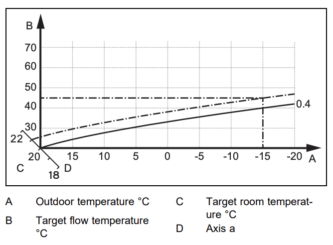

That is not the case. The heating curve adjustment sets the shape of the curve but the set desired temperature (if set to anything other than 20C) offsets the curve. This is explained on page 4 of the manual here
The chart explains well how the heat curve and manual temperature adjustment work together.
