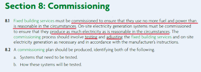

Building Regs Part-L puts the onus on the installer to create the Commissioning Checks.
Using a 'standard' MCS form without stating what mounts are being referred to is clearly inadequate.
To test whether condensate drainage will be adequate, the installer may have poured a bucket of water onto the ground.
If so, then that too should form part of the Commissioning checklist.
