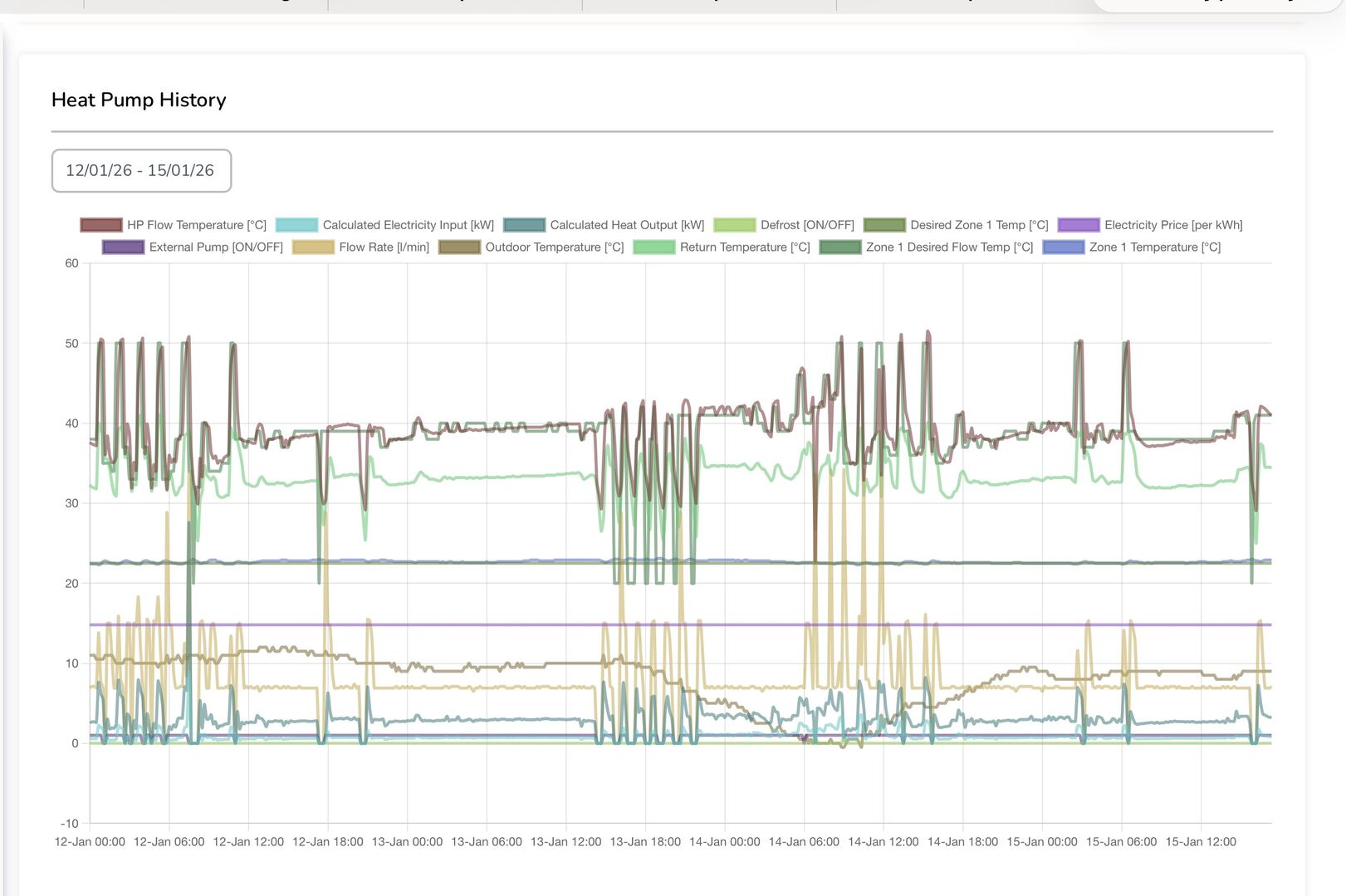

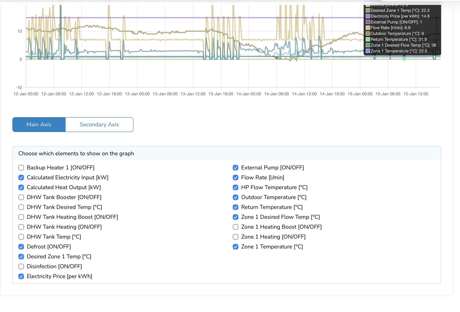

@burtis I can’t be sure if all systems use the same set of parameters (in my instance, I don’t have DHW powered via the heat pump nor any additional heaters in the Daikin EDLA08 monobloc that need to be reported). What I have done is take an image of all the plots I am able to use but bear in mind, you can select one or more to view as you require. The other image shows the selection table to choose various elements. Regards and congrats on being given access to the app!

@toodles brilliant thanks for the reply.
The graphs look like they would be very useful.
What I'm wondering is what settings can you change IE flow temps and that sort of thing.

@burtis I only use the app to see what is going on and have not investigated what (if anything) is controllable with the app. I know it infers the installer can monitor and adjust but I know not how. Regards, Toodles.

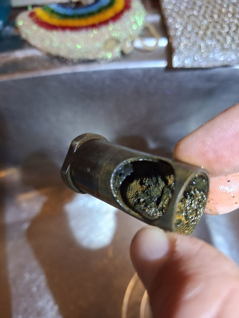

Must of knocked a load of crud through when they added the glycol finally. 2 days after a filter clean. Picture added of the filter
Even though they had advised against it as they used liquid PTFE and apparently it can break it down, but to appease NAPIT it had to be done.
