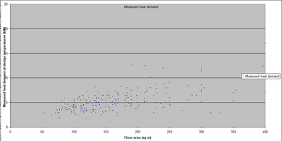

OK.  For comparison my house is 200sq m, 250mm loft insulation, a mix of  solid wall with IWI, uninsulated solid wall and lightweight block, double glazing, uninsulated floors.  7kW.  It is fairly close to cubic  which obviously helps.
Based on this and the scattergram below from heatpumpmonitor I think its quite likely yours is actually, <10kW, but whether its low enough for the Vaillant 7kW machine (or anyone else's ~8kW)) is clearly rather doubtful, and the 10kW Vaillant is just the 12kW downrated so not much point in that.  Thus I can understand the choice.  Since Heat Geek are guaranteeing performance, if it turns out they have seriously overestimated loss and it manifests itself in poor performance, they are presumably on the hook to do something.  Perhaps another reason to choose Heat Geek.
