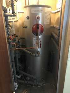

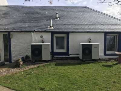

68F99A49 929A 44F0 BA3A 5509D66A2F45
E78B6541 7A88 49F0 A31D ECB5C6713F6F
The firm are Renewable Clean Energy they have fitted over 50 systems in the area and cover Fife. There are many companies sprinting up like the old solar panel days but unless they are trained and really know their stuff it is you who pays!  i strongly suggest you give then a ring. We have a very similar system to that you mentioned perhaps a slightly smaller tank with buffer in attic above tank. 2 pumps as in the photo quite large but quiet - our bedroom is the window to the right of the right hand pump and poses no problem even when it comes on at night which it does to keep the main house at 18 degrees ready for the boost to 21 at about 6am
i have just checked the amount of electricity we used for the full march and it is showing that we used 1137kwh so at our price bans march with the cold weather cost us £199 so i am very happy with that we have also found that after the first week/10 days as the house warmed up our costs seemed to drop a little. The expensive bit was ripping out all the micro bore we had installed 38 years ago which at that stage was easily installed under flooring etc we had a much bigger job and decided in the end to run some pipes surface - next job is to box them in but not critical! The large rads and wide flow pipes have ensured the main aim is achieved and we have never been this warm and saving money
