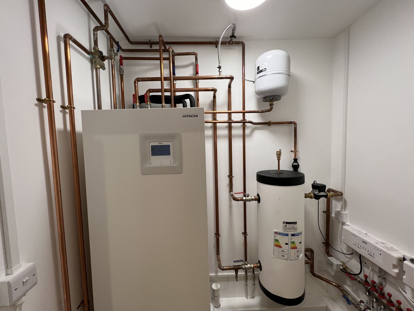

Working through your comments.  Picture attached.
IMG 9522
Vaillant aroTHERM plus 3.5kW
50 litre volumiser
3.6KW solar panels
Tesla 13.5kw Powerwall 3

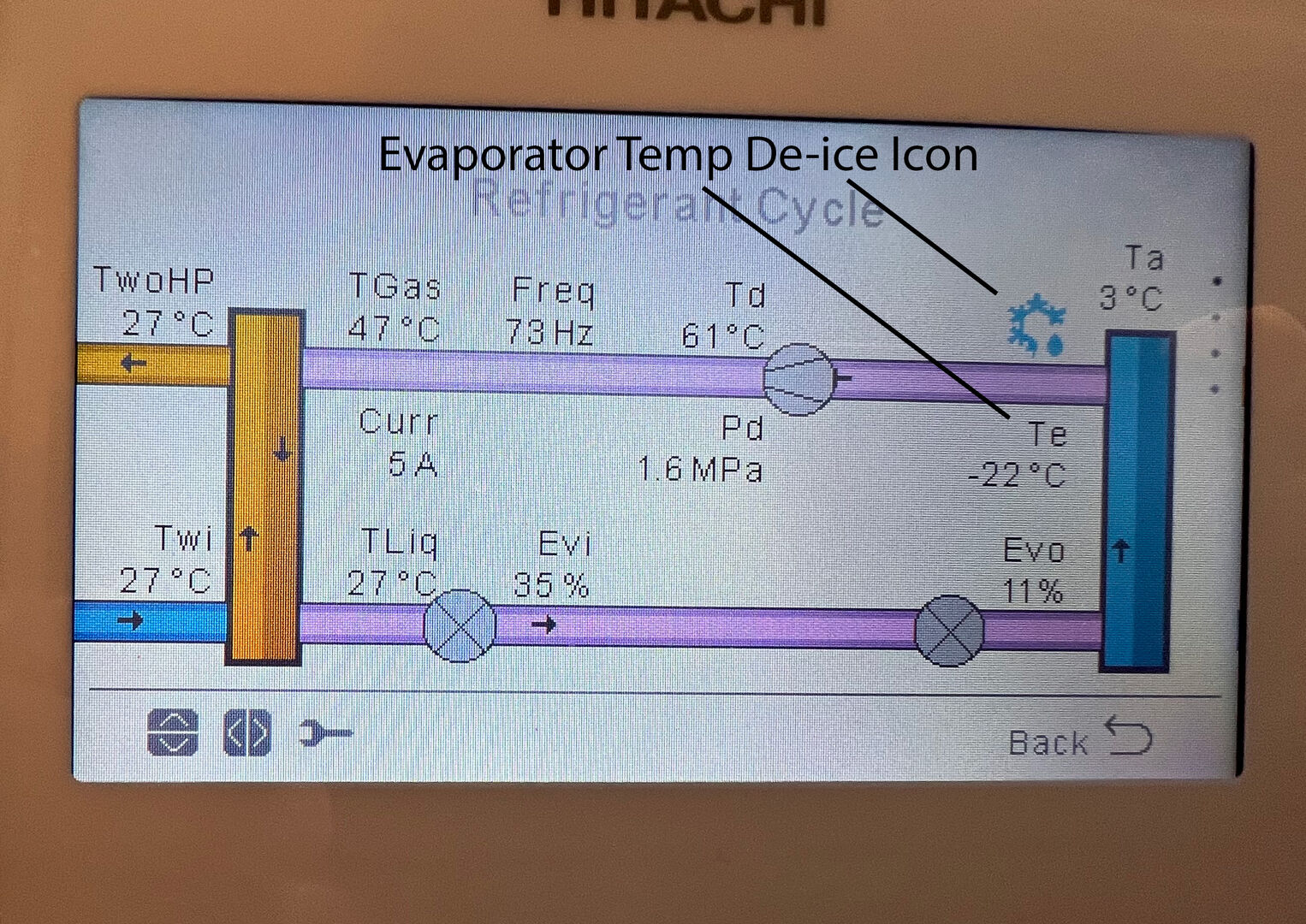

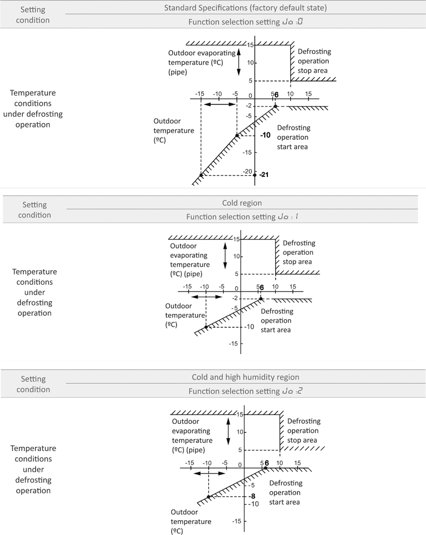

Could I ask for your interpretation of the defrost algorithm for the heat pump?  I am seeing a defrost at around an outside starting temperature of 5C.  The evaporator gets to -18/20C prior to starting the defrost cycle, at that time the HP is well iced up and rattling. It’s about 40 minutes between cycles. I have also included an audio file of the HP making its noise ( I may not be able to post the a mp4 file).
Attached is the  display showing de ice icon and evaporator temperature.
I have attached the manufactures document on the defrost algorithm which I do not fully understand.  I have been previously informed that my setting is JO-2.
Does -18C evaporator sound to cold to you? How about the rattle?

Posts: 5629
Posted by: @trebor12345
Thats expected
I wouldn't expect it to rattle. can you tell what is rattling?.  I would expect it to be iced up
Does -18C evaporator sound to cold to you? ?
Honestly no idea what cycle they run but the refrigerant has to be colder than the outside air otherwise it cant possibly extract heat from it!  The bigger the temp difference the faster heat is extracted so I could imagine that this is the temperature.
This seems to be related to the (low) temp at which the defrost operation stops.  I didn't know there was such a temp, I assumed it just measured (somehow) how frosty it is.  The description 'cold and high humidity' certainly fits the UK quite well though.
Sorry I cant be more specific.  Have you got any reason to suspect a fault?  So far I haven't seen one.

It sounds like its ice build up and does not sound good.  Looking at the algorithm it looks like I am set to the Jo-0 setting, but I don't fully understand charts!  No specific problem just the noise it makes prior to defrost.

PS thats a nice neat plant room.  Shame about the buffer but otherwise its a neat job.  However there should be insulation on any pipework that gets warm particularly dhw pipework.
Thank you.
The pipe work is now insulated.
Finding a heating eng that knows Hitachi units in this area is difficult.  However, as you said a qualified air-con installer might be an option.
