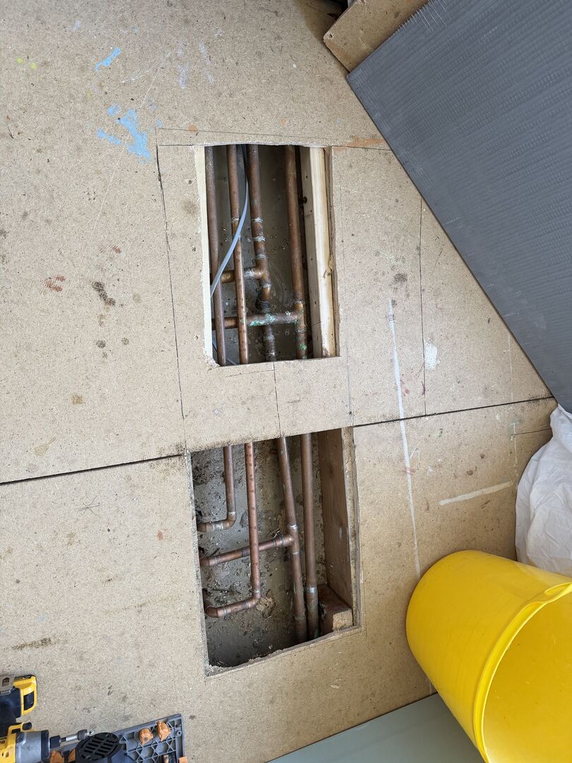

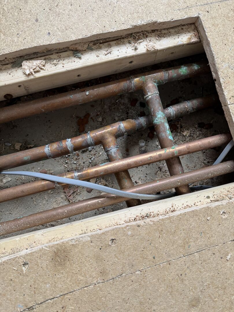

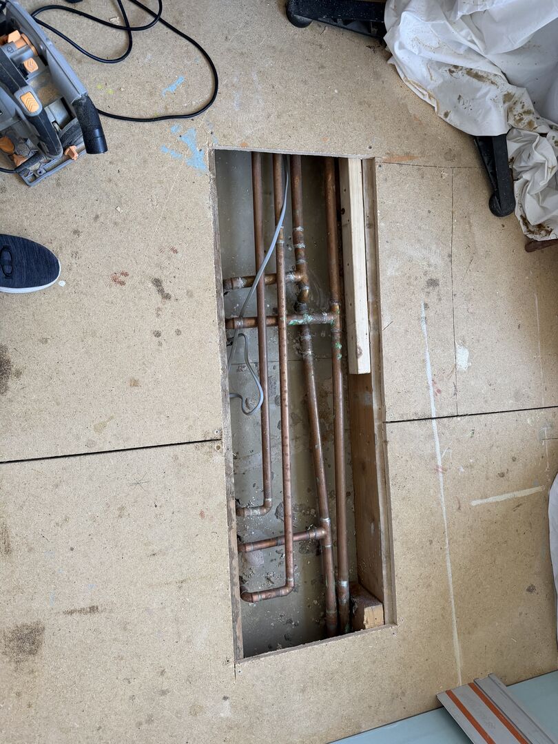

Ah the gift that keeps on giving! Finally getting around to refurbing the spare room, this is where the installers had to hack the floor apart to fix a leak because they didn’t pressure test the system before turning the water on for the second time, the first time they turned the water on they realised they hadn’t attached one of the rads so I had mains pressure water flooding my lounge! Anyhoo took up the old flooring and revealed what I can only describe as a masterclass in plumbing and electrical safety! This was installed Jan last year and that is the feed to the immersion!
