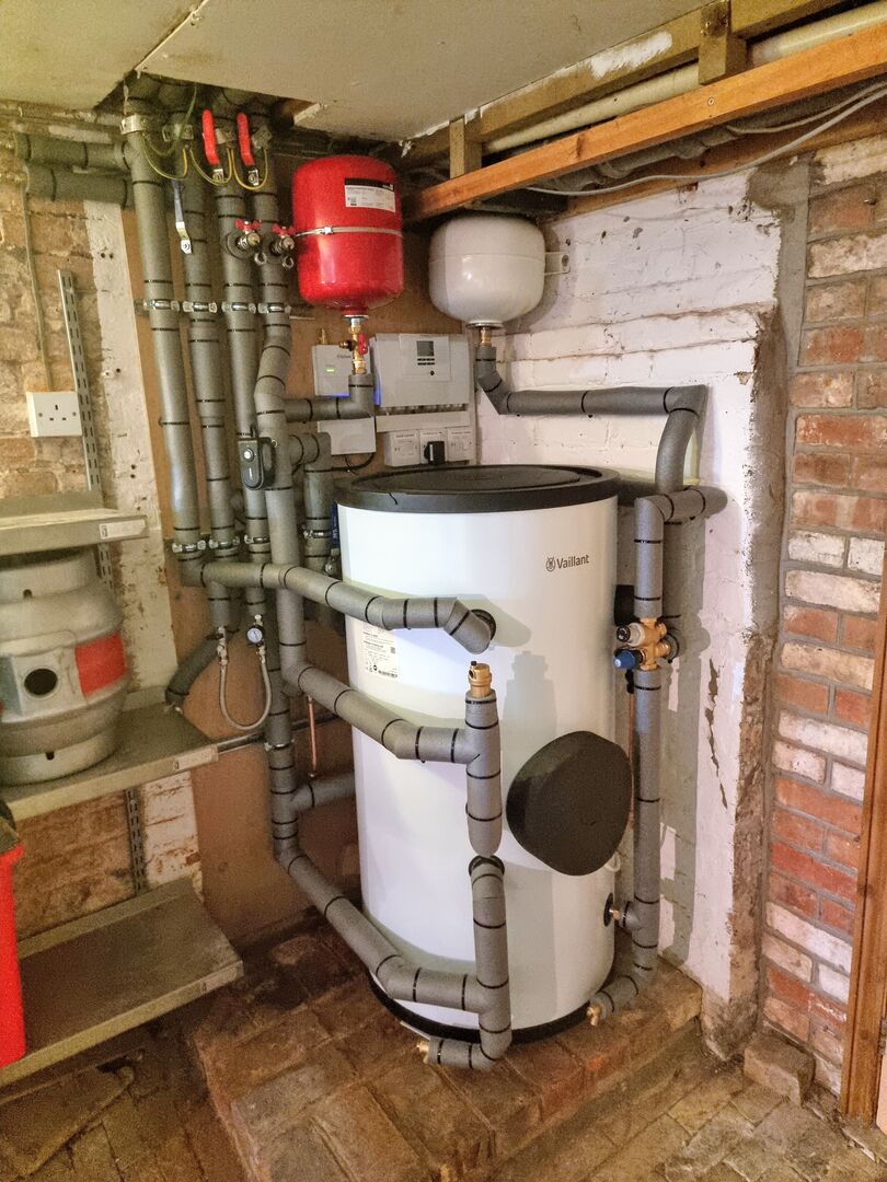

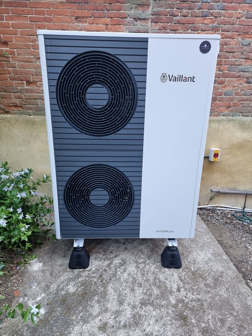

I had a Heat Geek lead install by Green Heat Norfolk. They are still more likely to install fossil solutions than HP's but there approach to the job was excellent. Mine was a pretty easy install really, concrete pad to support the 12 kW Vaillant ASHP was already there and the hole in the wall to install to the premises was vacated by the old oil boiler flue. Only needed 4 radiator swaps in an old 80's converted barn but required a HW tank, placed on the vacated plinth the oil boiler stood on, like I said simple really.
The big worry was the heat loss might be too big but subsequent analysis of the performance is it is probably over sized. GH used the HG method for establishing the heat loss but it seems to me that a lot of these analyses are way too conservative. I carried out a lot of fabric improvements to the building, sealing and draught proofing every leak that an air permeability test had cruelly exposed before the HLS, but I don't think enough credence was given to this. The thick brick walls, no cavity insulation, due south facing, act as an amazing thermal store and the overall COP since install (April 27th) is a creditable 4.8. I have carried out a lot of analysis of the data, using AI, to help tweak the system to arrive at this position. I am not a heating engineer and certainly not a "practical chap" or a data nerd. Hopeless on both counts I'm afraid, hence the heavy leaning on AI.
This was necessary as understandably installers tend to use settings to ensure they don't have to come back to "fix" complaints of being cold or experiencing luke warm water. They therefore tend to set high.
The install was quick, very tidy with great attention to detail and looks very professionally installed. However, I think there is quite a lot of improvement that the owner can make if they are prepared to really get under the bonnet of what the data offers them.
Should you have to do this? Well yes and no. If you want to chase the nth degree of COP yes you will have to, that doesn't mean to say that the installers shouldn't therefore leave it entirely to the owner, they should follow up to see what if any changes have been made or make suggestions once the data, which is available to them and Heat Geek - they asked permission to have it- has accumulated to the point that positive intervention becomes obviously needed. GH have not done this, in fact not a peep.
A couple of pictures showing the install. I have since insulated the exposed pipework still showing to improve tank heat loss even further.
