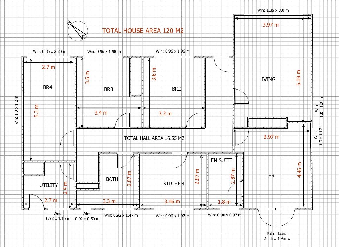

Attached in an accurate schematic of my bungalow.  What has been labelled as BR4 is actually the integral garage - it's had the doorway bricked up and a window installed, but it's by no standards a habitable room.  It houses the new water tank etc. and is a workshop with 1 outside wall as yet uninsulated and a bare, uninsulated concrete floor.
Floor plan

Perhaps just as pertinent is how their own measurements conflict with each other.
  • If BR4 is 2.62m wide, how can the utility be 3.36m wide if they share the same internal wall line?
  • How can the living room be 3.8m wide and BR1 be 2.8m wide at the same time?
  • How can the utility room be 3.98m long if the kitchen is only 2.8m in the same direction? And how can BR1 (an obviously longer room) be only 3.41m long?
  • If the length of BR3 (or BR2) plus the width of the hall plus the length of the kitchen or bathroom total 7.68m (plus wall widths), how can the lengths of BR4 and the utility room add up to 9.15m? Is the wall between BR4 and the utility room a metre and a half thick?
To my mind this all adds up to a dramatic lack of basic sanity checking. I wonder if any other forum members know what form of redress could be available under the HUG scheme; free the installation may be but the installer's miscalculations are going to cost you money on an ongoing basis surely there's a mechanism for the powers that run the scheme to haul the installer back to correct their mistake - Sale of Goods Act and all that.
In fairness, if the installer gave you the documentation without any prevarication it does suggest the mistake is an honest one. Who knows; they may be perfectly prepared to put their hands up, admit the error and resolve the issue with minimum fuss. I'll be interested to see how they respond.

Absolutely!  You only have to look at the plan to see the room measurements don't make any sense.
The chap who gave me the documents said "no clue!" when I mentioned the cold bedroom & incorrect sizes on the plan and said he'd pass my email on to the "technical guy".  He is clearly just a pen pusher and may have put the cat amongst the proverbial pigeons by giving me all the documents 😉
