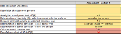

I had a go at using the MCS calculator for the Vaillant plus 7kW VWL 75/6, assuming it will be hanging away from the ground (I assumed the barrier would be the wall of the neighbour; is this how it should be filled in?)
Firstly check you are using sound power not sound pressure. Some manufacturers arent entirely clear and both are measured in dB(A). From memory the sound power of the current Vaillant 7kW is 55dB(A) or there abouts (I forget exactly).
Assessment position is the most affected aperture (window/door) on an adjacent property (if there are multiple you must do it for all). Normally the nearest but not always. You can ignore kitchens (solely used for cooking), utility rooms, stairwells, halls, bathrooms, only 'living' rooms and bedrooms count. You dont have to calculate the effect on your own property!
Reflective surfaces are any hard surfaces within 1m. So the minimum possible is 1, unless its cantilevered >1m out from a wall and > 1m from ground.
A barrier is one between the ODU and the assessment point, not one at the assessment point.

Posted by: @jamespaAssessment position is the most affected aperture (window/door) on an adjacent property (if there are multiple you must do it for all). Normally the nearest but not always. You can ignore kitchens (solely used for cooking), utility rooms, stairwells, halls, bathrooms, only 'living' rooms and bedrooms count. You dont have to calculate the effect on your own property!
Fantastic. This is all I needed.
Afew planning applications from the neighbour confirmed no opening windows on living spaces facing us. So the only thing restricting siting of an R290 would be the exclusion zones. But even before the Vaillant anthracite arotherm, it will be straightforward to site the ODU for a zero disrupt next to the old combi boiler.
