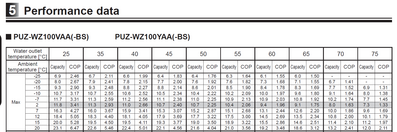

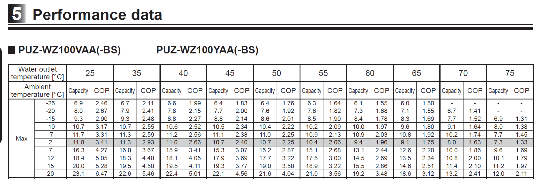

I've shared this table in one of my posts recently, as I have the same unit as you, but the 5.1 COP you refer to is only one number quoted within their table, and is the highest figure quoted within these, under the "Partload2" element of the testing, when the capacity is restricted to 5.8kW.  The COP figures range from 3.67 to 5.10 at those temperatures within the table and these are from tests carried out in laboratory conditions, so about as 'real-life' as the MPG figures quoted for vehicle fuel efficiency.
Screenshot 2025 12 14 200658
This isn't to say that there's no room for improvement, as I've been investigating the COP of my own system and am in the process of trying various means to tweak any further COP efficiencies from it.  The closest 'real-life' reference point I can provide at present is from 15th December, where my system had a reported heating COP of 3.42 on a day with average OAT of 9.2°C and an average flow rate of 33.88°C when running under weather compensation that day (figures provided via the Mel Pump app).  These also fall short of any of the reported figures in the table, but these are being run on a retrofit installation, with 'real-life' performance inhibitors having an influence on what the true maximum is.  I suspect there may be further tweaks available that will have a positive impact, but my gut feel for now is that 3.8 is likely a realistic maximum for my installation at those temperatures.
I would be inclined to disregard the 5.1 COP figure as being anything close to realistic.  I found the table to be really helpful as a means to re-base my expectations in terms of questioning "what good looks like" for my own specific circumstances.
