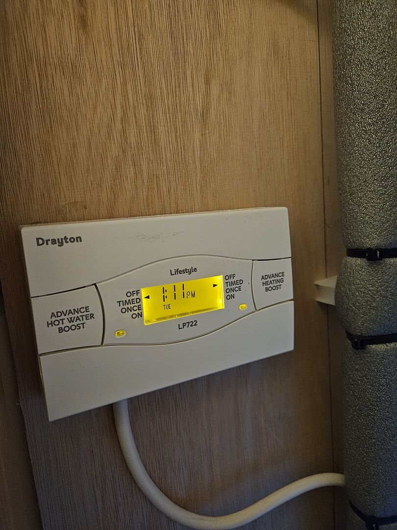

So my question is about the Drayton controllers. Do they override the weather compensation? Currently I have the thermostat on the wall set to 20c and its saying its 18.5c and theres the little flame so calling for heat but the ASHP isn't showing as being on on the grant controller. Any help appreciated to get the system working as efficiently as possible.
I agree with @dgclimatecontrol. The Drayton controls (and any other third party controls) almost certainly shouldn't be there as they will conflict with the heat pumps own controller. Best bet is to turn them up as @dgclimatecontrol suggests and run the heat pump on its own controller. You also (for best efficiency/max comfort) want all or at least most of your TRVs turned to max and then to adjust the weather compensation down on the Grant so your house is at the right temperature. Its worth reading this introduction to heat pumps
The controller below I think seems to be controlling what hours the heating is on?
