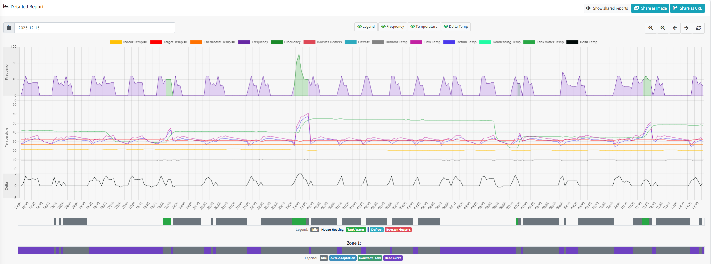

(@sheriff-fatman)
Posts: 224
It may be switched on 24x7 but is it cycling heavily because of eg low sysetm volume caused by circuits being switched in and out.  Some plots from MelCloud/Melpump of FT, OAT, IAT would be most helpful
@ciocoiu-alexandru I can't provide the same level of diagnostic insight as others, such as @jamespa, can but I'm aware that MelCloud will only provide an hourly snapshot of the data outlined above at a time.
In order to assist the others is diagnosing any issues, I would recommend that you use the free 30 day trial available with Mel Pump, which you can connect to via your MelCloud login (or, if you prefer, by setting up a guest account in MelCloud for it to read the data).  This will give you access, almost instantly, to a detailed report similar to below, which is one I've just taken from my own free trial account.
I hope the others are able to assist with your technical issues in due course.
Screenshot 2025 12 15 135416
