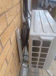

I thought I would share this DIY split system air to air a/c install. This is an R290 propane unit sold by Appliances Direct after the buyer said he would arrange his own F-Gas registered installer to fit. He then tried to fit it himself. This install was shared on 'World Refrigeration Day'. How ironic.
The buyer 'bled' gas from the system until liquid flowed, yes he bled propane from a pre-charged circuit. He fitted the wall brackets back to front, he had no pipe cutting, brazing, OFN, flaring tools, so bought a ridiculously long interconnecting pipe kit and coiled it up behind the unit air inlet, he didn't fit an external lockable isolator, he switched it on, it didn't work. No surprise there.
He then he called the same company he'd previously got a quote from to install a split to come and put it right. Topping the bill, he said he had a cylinder of propane patio gas the installer could use so he didn't need to buy any R290....
And that, ladies and gentlemen, is why F-Gas regulations exist and why these things are best left to time-served tradesmen.
