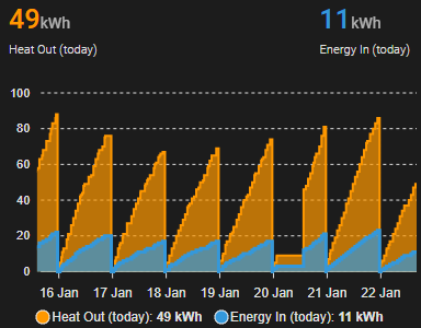

It seems there was a treasure trove of data collected by HA though. Today, I created a quick apexchart to look at my COP over last week (the gap on the 20th is where I lost connection to the wall unit again and hunting for a solution ultimately led me to this forum).

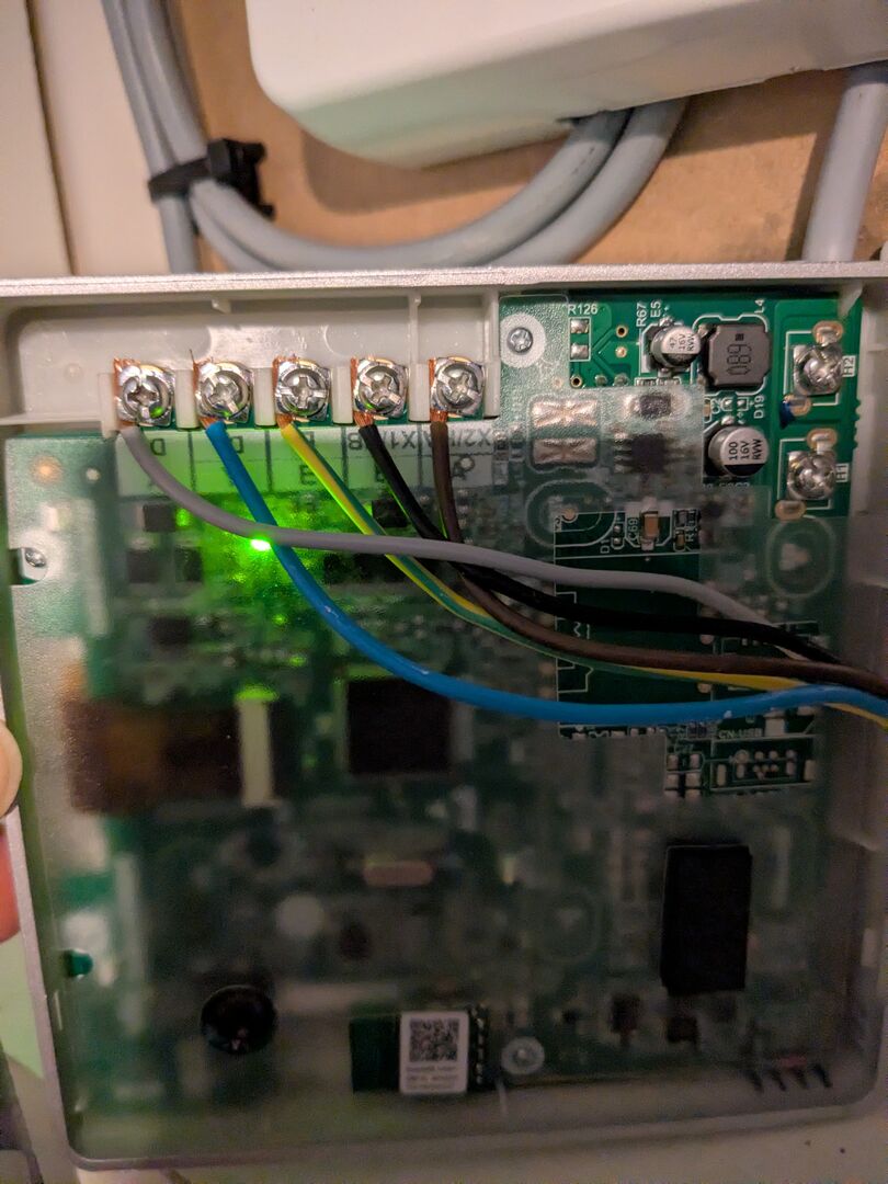

I should have said, I think it's not compatible. See pic. I can't see any cables going to the H1 / H2.
Or is this the stuff I am supposed to wire up? I am scientist. I mix liquids for a living. Lose cables scare me 🤣

From what I can see from here, that looks very much like the 5 wire version that is compatible, not the two wire version that's not, @schnetf.
As for modbus, rather than drilling holes in walls, have you considered running the cable up the wall to the soffit and then into the house that way? A wired connection is far more reliable than wifi, and if you've got a router cabinet I'm guessing you've got structured cabling so you could easily make use of that, simply getting the wire to the nearest RJ45 socket and then routing back to your patch panel before using a patch lead from the panel to the RS485 to Eth adapter.

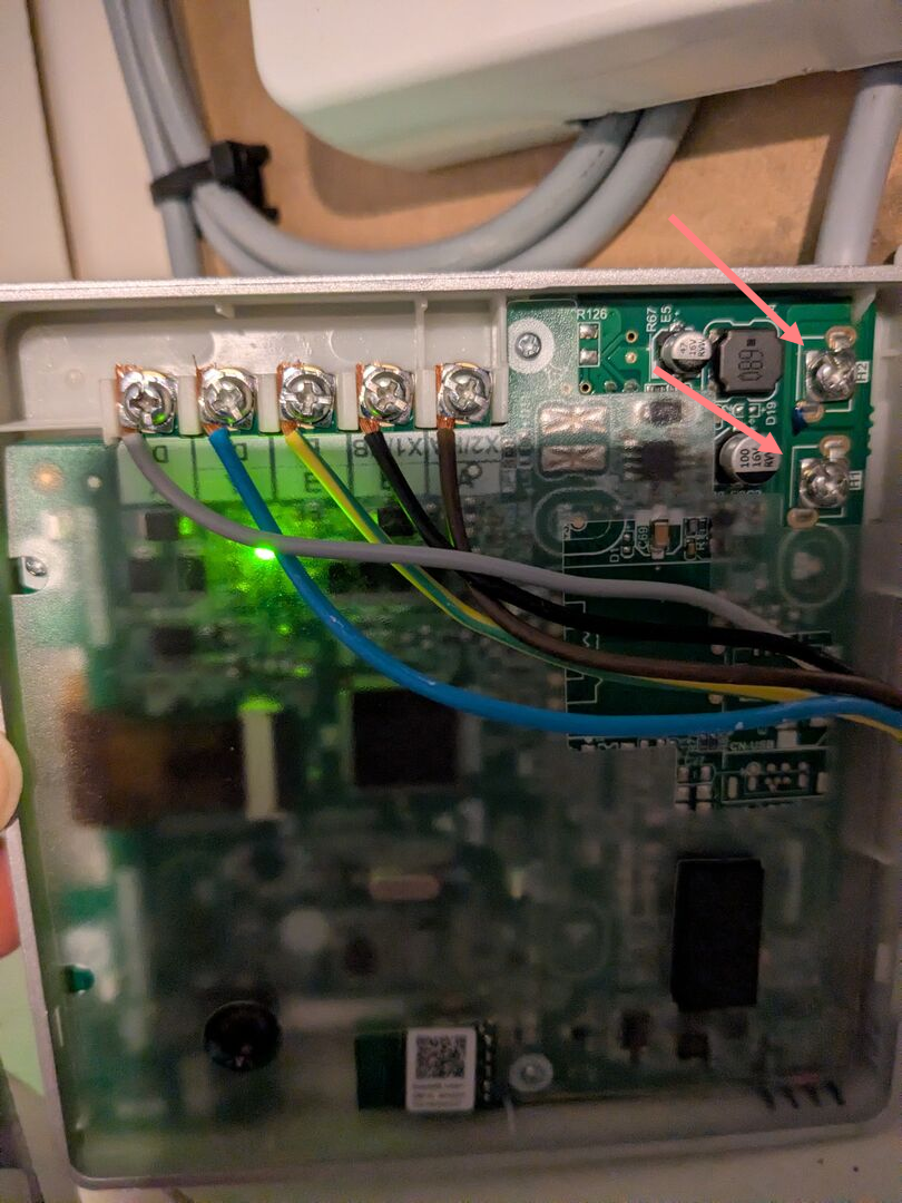

@schnetf — have a closer look at the arrowed connections, I think they are the modbus connection terminals (the photo is a bit blurred):

@schnetf As @cathoderay and @majordennisbloodnok already said, your controller has the required 5 connection points.
