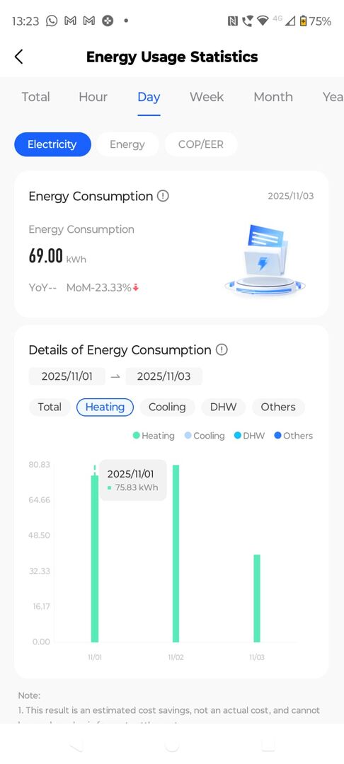

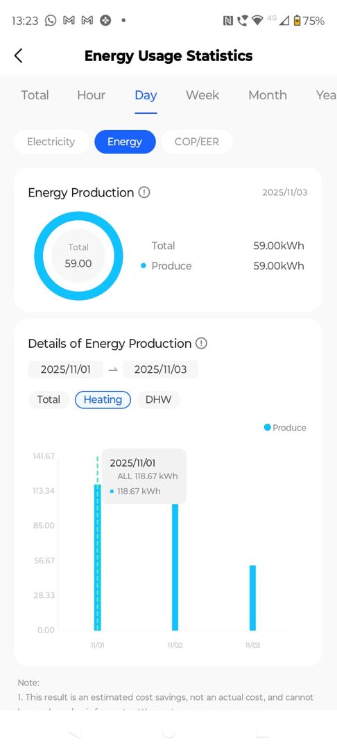

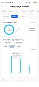

@cathoderay and of course others. Has anyone tried to get energy out figures from Midea Smart Home? I am now getting energy in, energy out and COP but the energy in numbers (and therefore COP) are nonsense. For example, November 1st showed energy in of 79kW while my actual total energy usage for that day was 33kW and my base load (without heat pump for heating/DHW) is around 13-14 kW so max for heat pump should have been in the region of 20kW. Given how far out that is, I have no idea whether to trust the energy out number, which was showing at 118kW, which implies a COP of 7.75 for the day as a whole based on my actual energy in number. Very frustrating!

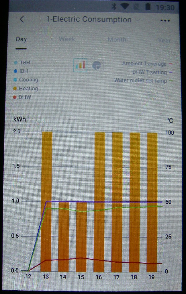

@pash44pump - I stopped using the Mide app ages ago, so my memory is hazy, but I vaguely recall (at least I think I do) two things:
(1) it uses total cumulative kWh in and out as its basic data, ie lifetime kWh in and out. Thus if the energy in is 100kWh at noon today, and it was 97kWh at noon yesteday, then i have used 3kWh over that 24 hour period. It uses the lifetime data to do the interval calculations
(2) it uses integers (whole numbers) for this lifetime data. Over longer periods, that's OK, but over shorter periods it can cause rounding errors.
Note that energy is measured in kWh, not kW, which is power. 1kW of power (say a 1kW conventional electric heater) on for 1 hour uses 1 kWh or energy.
Posted by: @pash44pump
Bearing in mind the above note about kW and kWh, I would be seriously alarmed if you property was running at that power rating, which is roughly 40 3kW kettles all on the go at once. Over 24 hours, that will consume 2832 kWh of energy. At 25p/unit (or kWh), that is over £700 per day...
Check exactly what that 118 figure is: units, and over what period. If you can do it, posting screenshots might help. Here's a rare example of one I took when I did have the app. It shows an 8 hour period from a single day, with the hourly kWh in ranging between 1 or 2 exactly, no decimal places because of the integer based counting:

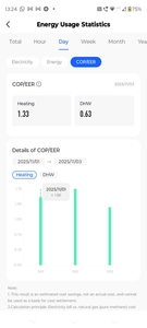

(@pash44pump)
Posts: 70

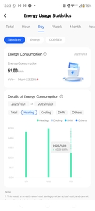

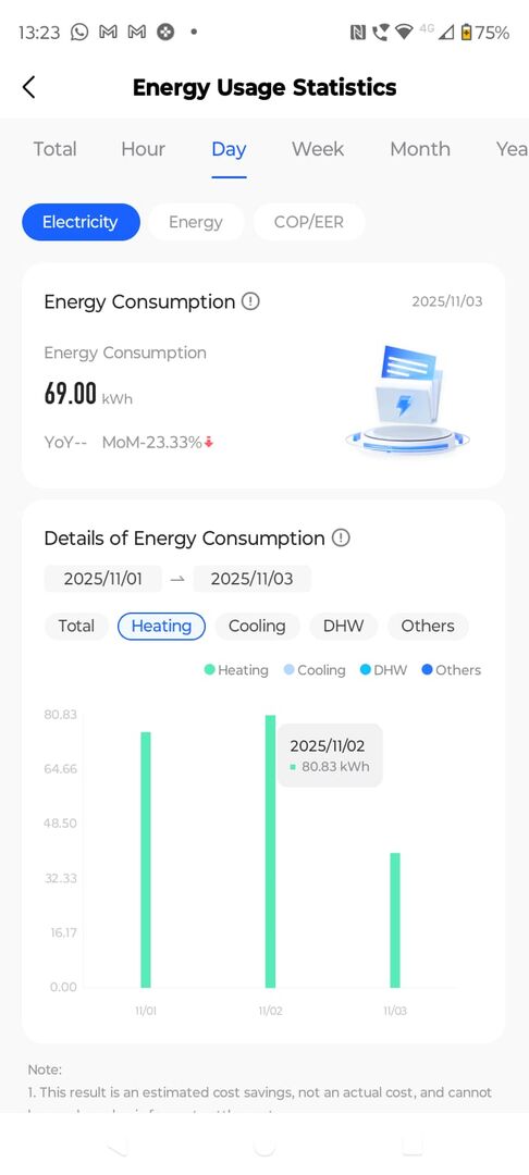

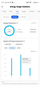

@cathoderay I think the app has changed. I don't see any screens like yours. It's now Midea Smart Home.
Here are screenshots of Nov 1st to Nov 3rd. You can see that the electricity consumption is crazily high. Doesn't even seem to over-estimate consistently on electricity used. One day it's 5x the next 1.7 times.
Nov 1st full load consumption was 38.5 kWh and the normal daily use without heating and DHW is 13-14 kWh. Nov 2nd was 50.1 kWh and Nov 3rd was 26.5 kWh. My estimations for last 3 days for heating are  . Smart Home reckons 76, 81 and 40 just for Heating. Energy out at 119, 142 and 53. No idea what is going on. Might have to just do manual readings.

cathodeRay
(@cathoderay)
Posts: 3163
Your energy: 9 kWh
@pash44pump - oh dear, it looks like they've managed to take a bad app and made it even worse!
I agree the data does not appear to make much sense. For comparison, for the three days your data cover my data (mean OAT / kWh in / kWh out / COP) for both space and DHW heating are:
1 Nov    7.0 / 17 / 87 / 5.1
2 Nov    5.9 / 29 / 124 / 4.3
3 Nov   14.8 / 13 / 75 / 5.7
In contrast, your kWh in / kWh out (as reported by the app) and COP (as calculated by me) for just space heating are
1 Nov    76 / 119 / 1.6     (when full load kWh in was 39)
2 Nov    81 / 142 / 1.8    (when full load kWh in was 50)
3 Nov    40 / 53 / 1.3      (when full load kWh in was 27)
Clearly something is very wrong! I can't even begin to make sense of it!
I think you have to do what I did, forget about the Midea app, because it is cr@p. A pity, they might have improved it, and it might have given you the sense check I hoped it would, but it seems to be the opposite, they have made it even more unintelligible.
