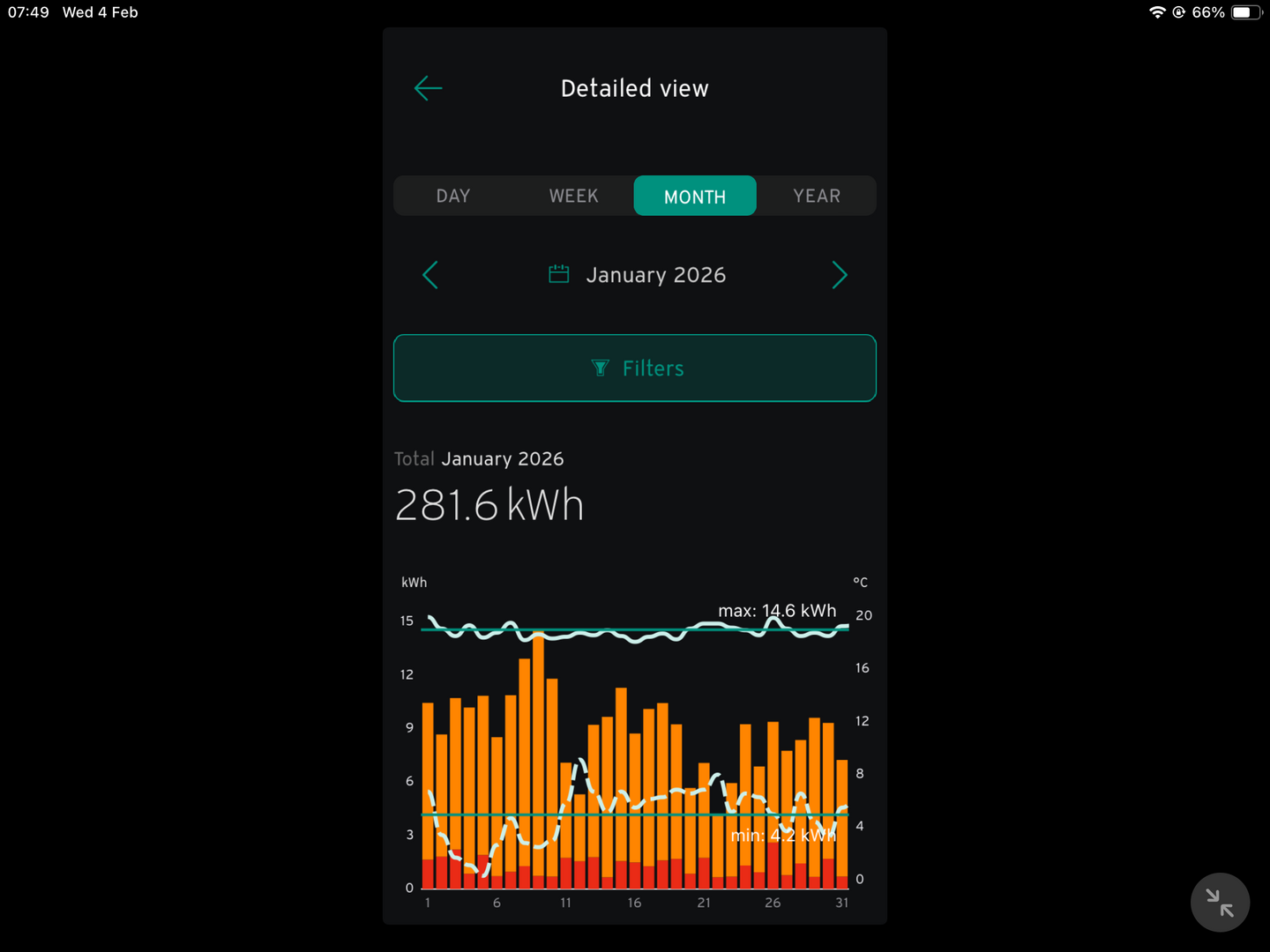

@johnnybudith Thanks for all the information.  It’s really helpful to know it’s out there.  Up to now I have been trying to get help from Vaillant customer service - which has been pretty variable!  The graph was eye opening!  I say that as our usage of heat is about 9kWhrs per day in January.  By the look of things that is low by comparison to the graph data so I assume many households.  We used 280kWhrs in January with hot water of 40kWhrs so roughly 15%. Screen shot below of the data.
I should probably add a note re our previous heating to explain my starting mindset and also how we run our house now.  Prior to the HP instal, wood burning was the only source of heat with DHW from an emerser and the wood only cost my labour.  Any added electricity adds to £ outgoings.  The house is over 100yrs old, 108 m sq and now insulated to a good but not exceptional standard - hence the heat loss of 3kW at -4C.  We still operate the wood stove for about 8 hrs a day.  The HP is on “active” and shuts off heat once the stove is going.  Hopefully that makes sense.
i have mentally been pursuing a COP equating to the pre sales info so roughly in line with what your system produces.  Being so far below is a surprise but part of my learning.  As an engineer by training and mindset, I am interested in what is going on and learning how to use the kit.
Finally, I didn’t understand you comment about sensors not being matched.  Can you explain?

The ashp measures exit and return flow temperatures which are usually designed for up to 5C. Thermistors have a measurement uncertainty of about 0.5C, depending on type and measurement circuit.
Re matching: If both sensors over read by 0.5C then the measurement difference is still 5C, but if one under-reads and the other over-reads then the temperature difference may be 4C or 5C, 5C +/-10% depending on on which way around they are fitted. The heat generated is calculated from this temperature difference and your 3kW may be within the range 2.7 to  3.3. The value of accuracy for the sensors follow a normal distribution so mostly they tend to the middle. But if the sensors were matched they are in the middle, and the heat output and hence the COP is accurate.
I suspect ours reads ~5% high and yours could be up to 10% lower than reality.

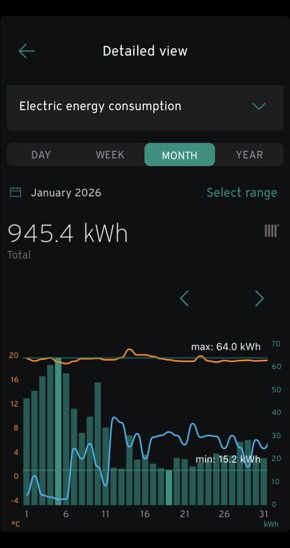

MdP’s is arithmetic manipulation based on the performance of his 5kW Valliant in a 3kW highly insulated house. His proportion of DHW is much higher I think, than either of us.
Our energy consumption is over 3 times yours for January it was particularly cold here at the beginning of the month. But the warmer later period lifted the COP average.
IMG 0942
There are many installations where the design and implementation is poor and the owners would love your value of 3.?
An engineering training is valuable in optimising and you can never have too much understanding (imho).
