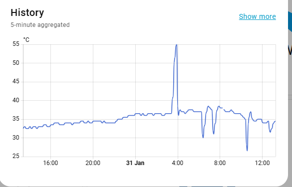

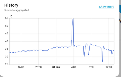

Home assistant is free software for monitoring and controlling more or less everything in the home.  It connects to the same server as the Vaillant app and means you can see whats happening with flow temp etc.  Useful for diagnosis but takes a bit of setting up.  It really needs to be on 24x7 so I run mine on a raspberry pi, but if you have almost any computer it should run.
Here for example is my flow temp for the last 24 hours
