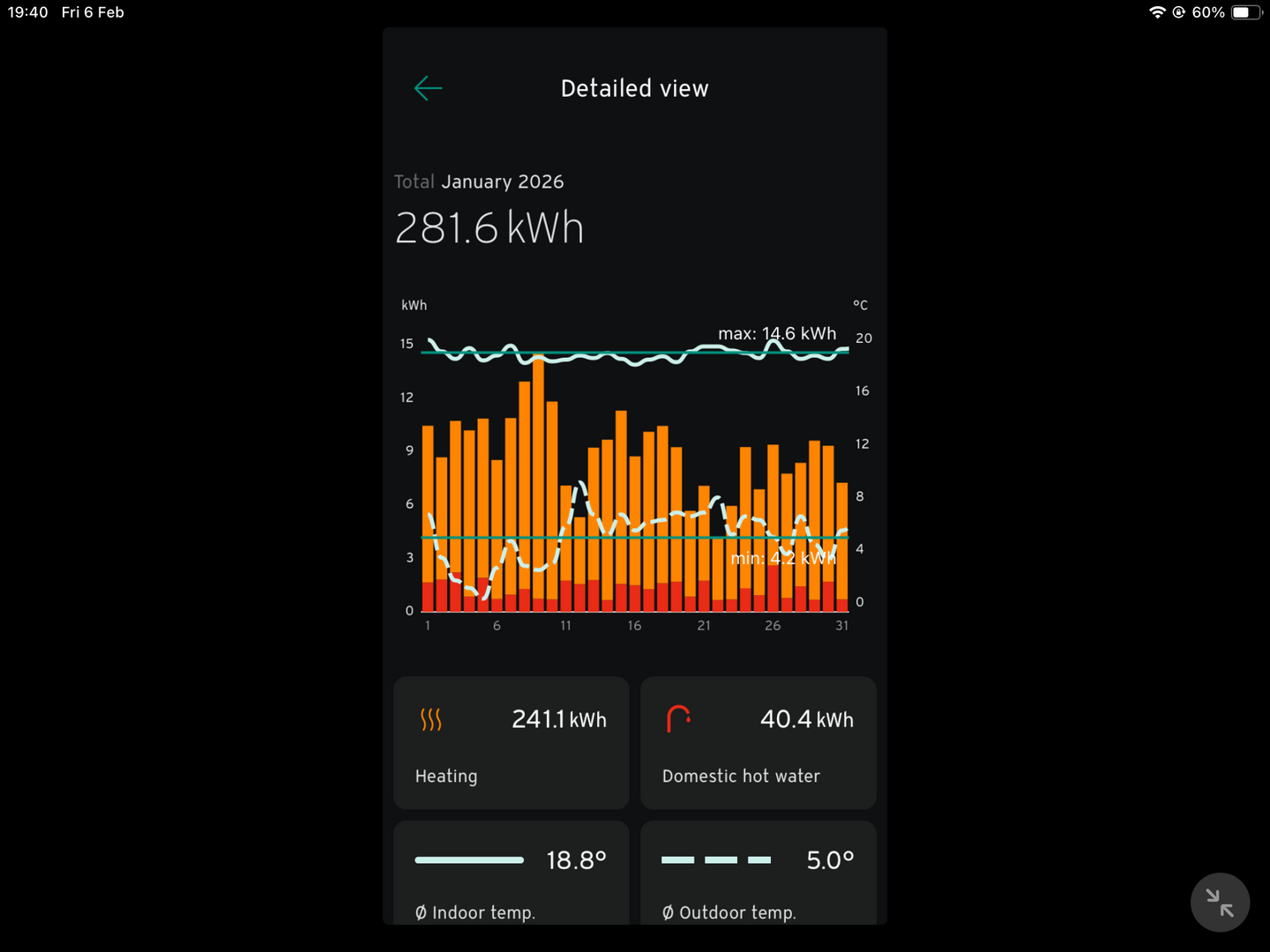

OK. What Im seeing looks fairly normal TBH:

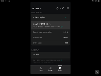

1 start per hour is good (1028 on off cycles in 1303 hours); there is no evidence of short cycling

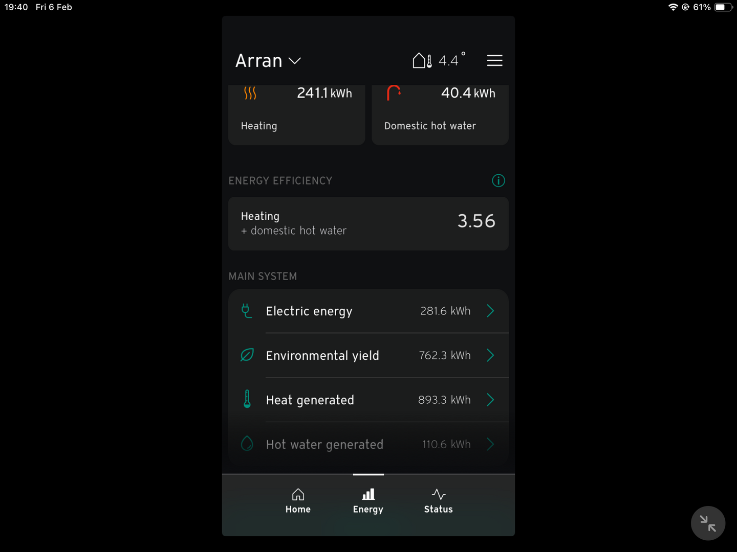

Unfortunately you haven't split out heating and DHW (you really should), which denies us some important information, but an overall COP of 3.6 in January given the ratio of DHW to space heating displayed compares to mine of 3.87 for the two combined, but with a much lower proportion of DHW in my case. I would estimate guess you achieved a COP of perhaps 3.8 for space heating alone, which is pretty reasonable for January, and therefore that you can reasonably expect a space heating SCOP of 4 or more (mine is 4.2). Your heating consumption of 241kWh compares to mine of 907kWh. My house is 7kW at design temperature suggesting yours is actually only about 2kW. This is consistent with 1 start per hour which is definitely OK but not 'top notch' for January,; the heat pump is somewhat oversized but with a 2-3kW loss thats absolutely inevitable and anyway necessary to give you decent DHW reheat time.
Basically I don't think you have any problem and should easily achieve a SCOP of 4 plus for space heating. DHW will always have a lower SCOP because you are heating to a higher temperature, I don't know if you have the opportunity to reduce this but if you do it will help.
I don't think you have anything to worry about but can I suggest you keep monitoring however to monitor space heating COP separately from DHW COP?

The energy consumed of 281kWhrs produced heat of 893 and DHW of 110 which equates to the given COP of 3.56.
40kWhrs was used in DHW production giving a COP of 2.79
241kWhrs was used for heating to produce 893kWhrs of heat so a COP of 3.7
i think those are the right figures but happy to be corrected. I am still very much feeling my way on the whole HP journey.
