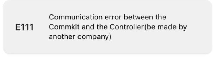

@tomf I’ve been sent this from a service engineer at Samsung that identifies the issue as a comms error with a third party controller.
