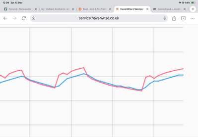

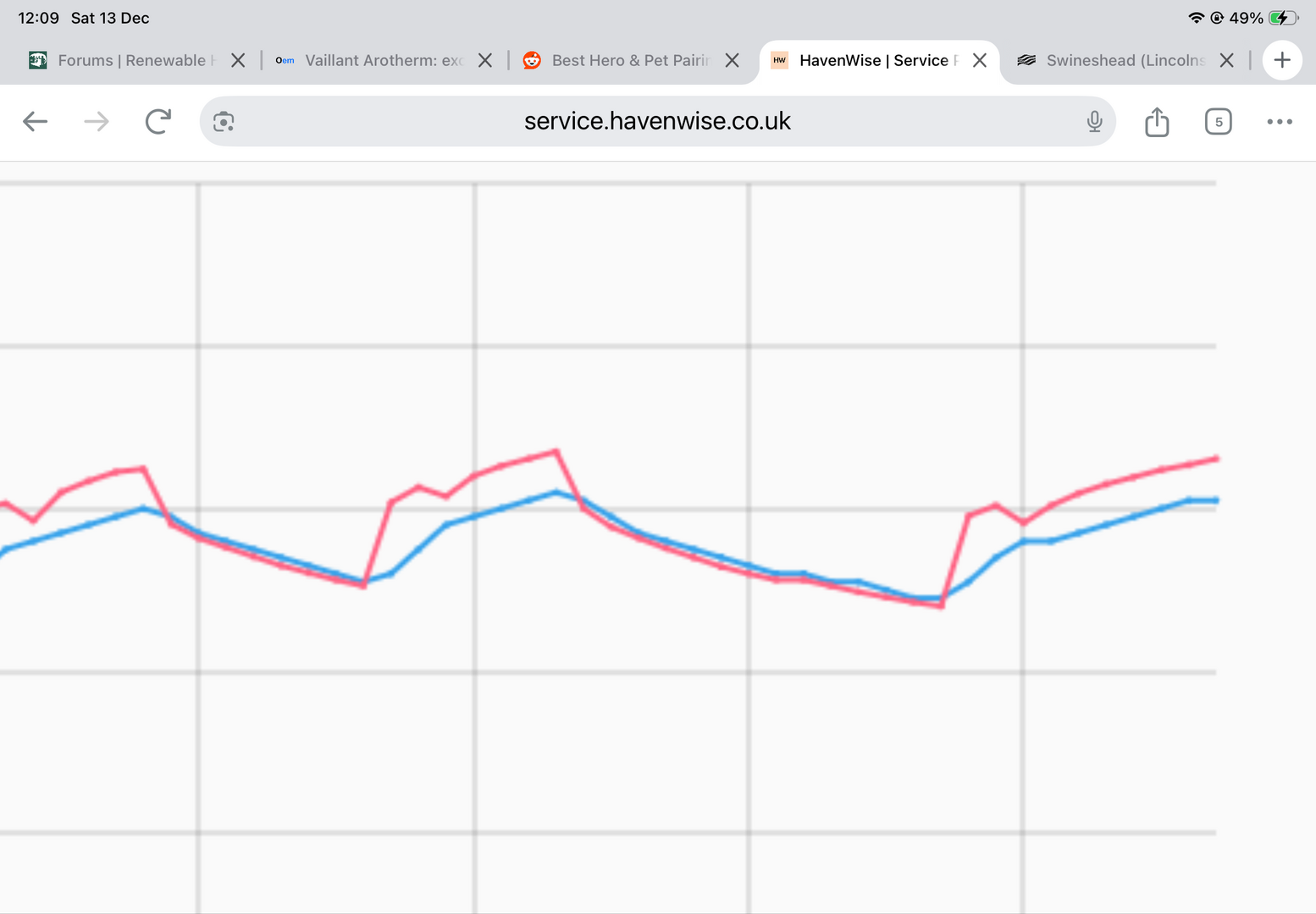

You can get an idea of if your flow and return sensors are accurate by measuring the difference between flow and return temps around 10 minutes after a compressor run has finished but with the pump still active. If the sensors are accurate the two values will be the same or with only a very small difference i.e. 0.1c. In my case, I have a difference of +0.7c on the flow rate which results in over reporting of cop in the Vaillant app. Maybe you have  an underreporting flow rate sensor.  You can check the live values using the VWZ AI controller.

IMG 1278
@simonf thats interesting as I’ve noticed my flow and return cross when it’s on cooldown not by much though 0.5c.
@adamk This shows that the sensors in your heat pump are not accurate. A not uncommon problem for Vaillant units. Therefore the COP reported by the unit will not be accurate. 0.5c difference sounds small but for a heat pump which happens to favour low DT's, even 0.5c is significant. Also, people with this issue normally find that the lower the outside temperature the greater the offset becomes.
