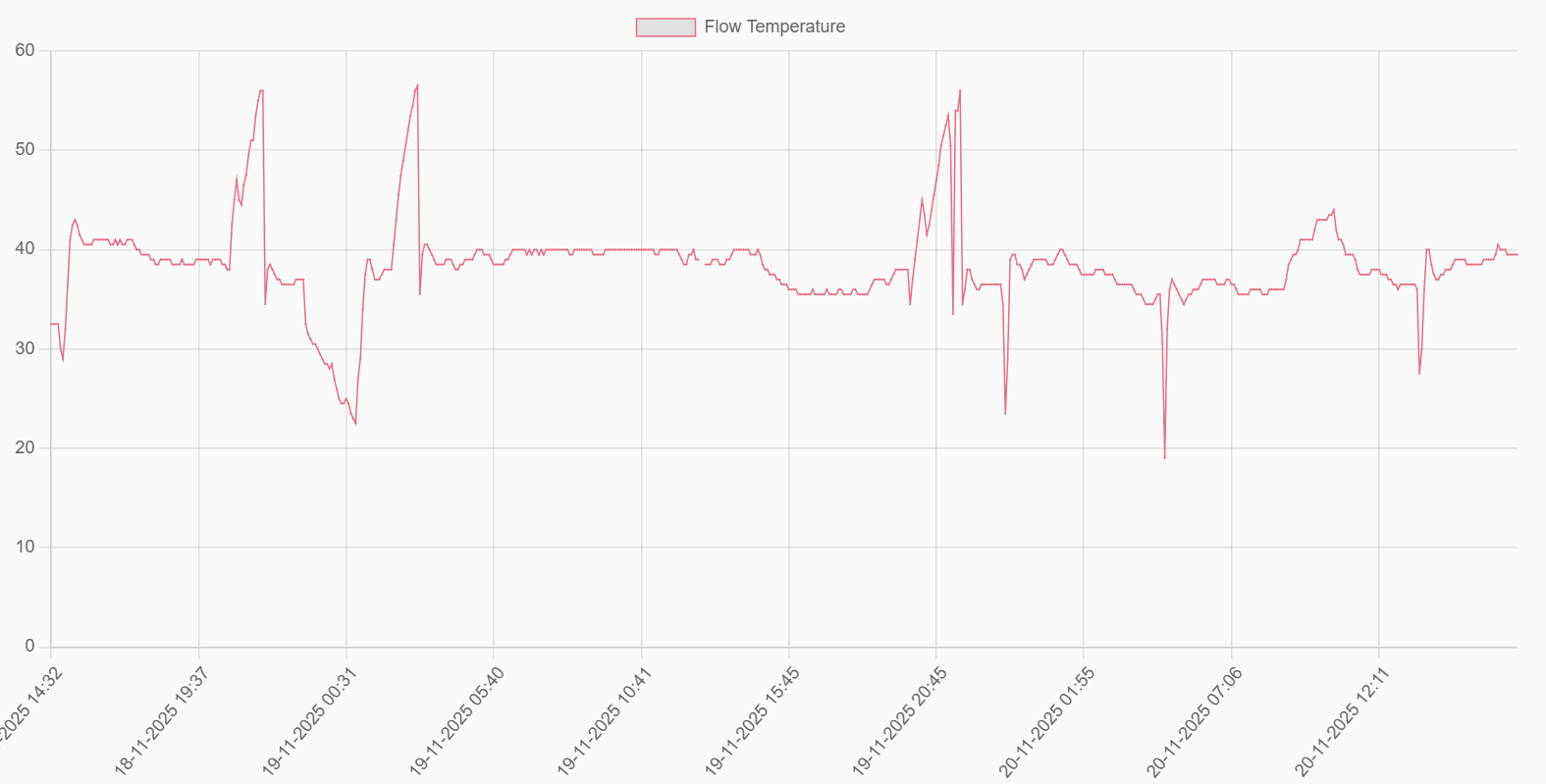

Are you able to post any graphs?
Unless its cycling or defrosting it should be achieving (at the heat pump) a COP close to spec. Defrost can cripple COP if it happens too frequently or goes too deep, and looking at the graph of FT might reveal whats happening. My current 24hr COP as reported by the heat pump is 3.2 (and falling, not surprisingly, it will go sub 3 I suspect), its defrosting irregularly but not more than every couple of hours

The power info is currently flaky (known issue with the integration) but you can learn almost everything from flow temp which is solid. Defrost should be visible and cycling too in the ft data.

It really would be good to look at an ft plot if it's still available, but it maybe havenwise highjack the feed.

@jamespa ive just pulled the flow temp from the Havenwise data, as im at work so cant spin up Home Assistant. its only a few days and the first few days were where it was in its learning phase. it certainly likes higher flow temps. still getting the same scop more or less, which is what i dont get, if im running effectively a higher curve it should lower the scop not keep it nearly the same.

Yes I expect the spike is recovering from defrost. Mine seems to go to 100% compressor modulation for 5-10mins after defrost.
