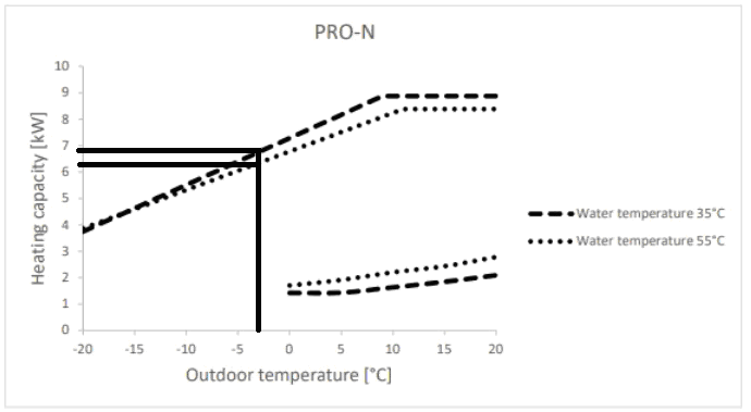

I have now had a reply from the company regarding my questions of the sizing of the heat pump. I think there answers are incorrect and would appreciate some second opinions on my answers. Thanks in advance:
Thank you for this information. Just to be clear my concerns are to do with the correct sizing, installation and handover of the system. Running costs while being of primary concern to Helen **** are a consequence of the other decisions made and are not part of my questions. However enabling her to be able to schedule when the heat pump is active would obviously impact them greatly, therefore a comprehensive handover is long overdue.
Any criticisms I make will be based on empirical data and Helen’s customer experience.
Something that I have not been able to find yet in your documentation is the value of the design flow temperature at -3°C. I would be grateful if you would state what this value is. I am assuming that it will lie between 35 and 55 °C, which luckily are the two lines on the graphs you have supplied.
Sizing
“To deliver the building heat load calculated at 5.8Kw plus the anticipated 1.2kw for the additional room which has long external walls and no heated space above requires 7kw at -3°.”
The 1.2 kW heat load for the possible (not certain) extension is a maximum figure and could be as low as 600W depending on construction. Therefore the total heat load is between 6.4 kW and 7 kW at -3C
“The smaller Pro N unit maximum capacity at -3° is less than 5Kw.”
Looking at the PRO-N graph you supplied, at an outdoor temperature of -3°C the range of Heating Capacity is between 6.8kW (at 35°C flow) and 6.2kW (at 55°C flow). Why do you assert its maximum capacity is 5 kW?
“The output range of the installed Pro R unit is 3.1Kw -18.2Kw, at the design flow temperature at -3° maximum output is 9Kw.”
Looking at the PRO-R graph you supplied, at an outdoor temperature of -3°C the range of Heating Capacity is between 14.7kW (at 35°C flow) and 13.2kW (at 55°C flow). Far in excess of your assertion of 9kW and far in excess of the heating demands of the property.
So in summary this does not answer my questions as to your choice of heat pump. In my view you should have selected a heat pump with a more appropriate output at the flow temperature you have designed the system for and not just inserted the next size up that you happen to have in stock.
Given Helen’s repeated pleas that she prefers rooms cool (18°C), the revised output of the PRO-N and the closeness of its output to the buildings requirements even with the possible extension, I believe the PRO-N would have been a much better choice.

if you have time could you please look at my reply in the post above and give me your opinions. Either I've got this totally wrong or they have or they are being deceitful. Thank you Mark

Posted by: @bontwoodyif you have time could you please look at my reply in the post above and give me your opinions. Either I've got this totally wrong or they have or they are being deceitful. Thank you Mark
Based upon the available information, I would say your assessment looks to be correct.
