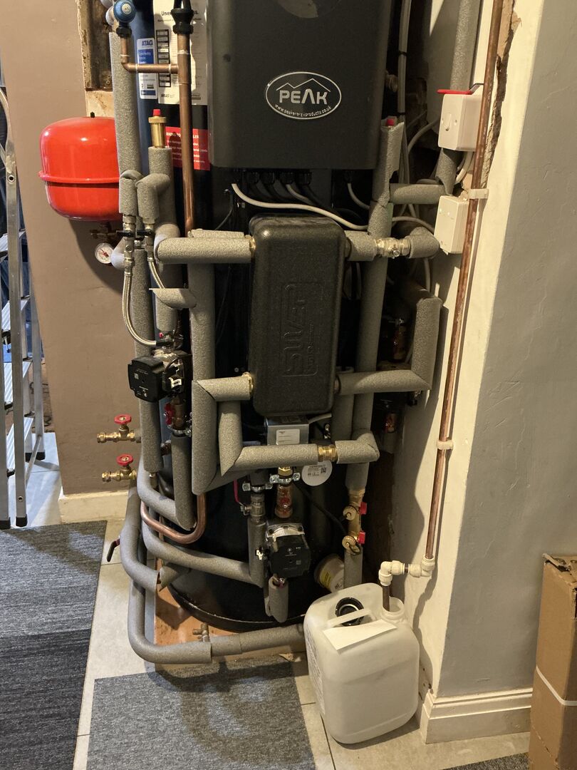

@johnd do you also have a plastic container to catch any of the glycol overflow if it ever over pressures?

@davec
PXL 20260110 173314123
Yep we do.

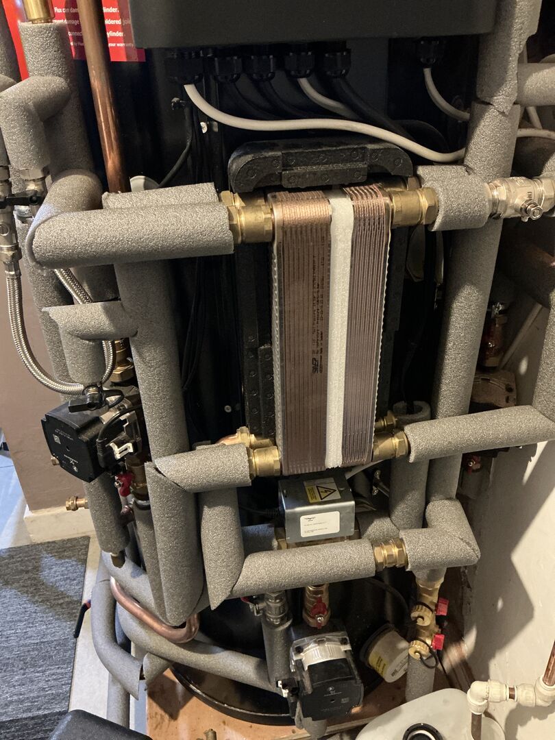

Is that a plate heat exchanger above the bucket.  Can you tell whether it is connected to the DHW or to the space heating between heat pump and emitters?
Did you say you have 2 water pumps?

@jamespa
yes it is a heat exchanger between the glycol loop for the external unit and the DHW and space heating loop.
Apologies we actually have 3 water pumps; 1 for the glycol loop, 1 for the space heating loop and then 1 more for the DHW.
I’ll work through the menus and get the pics for you.
Heat exchanger picture without the polystyrene cover (space heating on the rleft and DHW on the right), pumps also visible on the left, underneath and one slightly hidden on the right;
