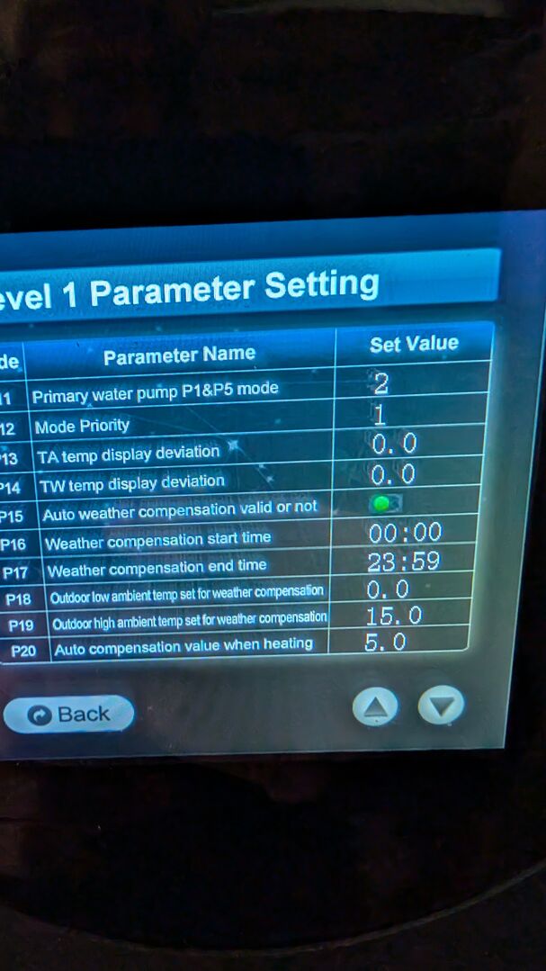

@jamespa The app seems to cut off the text 🙁 But on the unit it is "Auto compensation value when heating". There is zero help within the app that explains what these values are.

Hmm.  There maybe some more controls on the control panel itself.  Manual (of sorts) here  The manual is very light indeed on detail, they either didnt bother to write it or have deliberately hidden it.  You could try asking the installer?  The fundamental here is getting the WC settings right for all temps including - ones.  Its presumably possible b ut the app and manual are of no help at all!

@jamespa
PXL 20260110 125622747
From the indoor unit

Thanks, equally useless uinfortunately
It appears that the controls for this heat pump are different to almost all others on the market and, from what you have shown me, they do not expose in any obvious way the most important parameters.  Unfortunately they do not publish a manual that is of any real value.  It may be that a combination of adjustments to the parameters they do expose can achieve what you need to achieve, but without an description of how they relate to the actual flow temperature its impossible to tell.
I think that, in this case, you will need to ask your installer or their tech support line if they have one.  All you are trying to do is to adjust the weather compensation flow temperatures which is about the most basic configuration possible with a heat pump!
I am sorry I cant be more helpful but if you do ask your installer or contact the manufacturer please do let me know what they say
