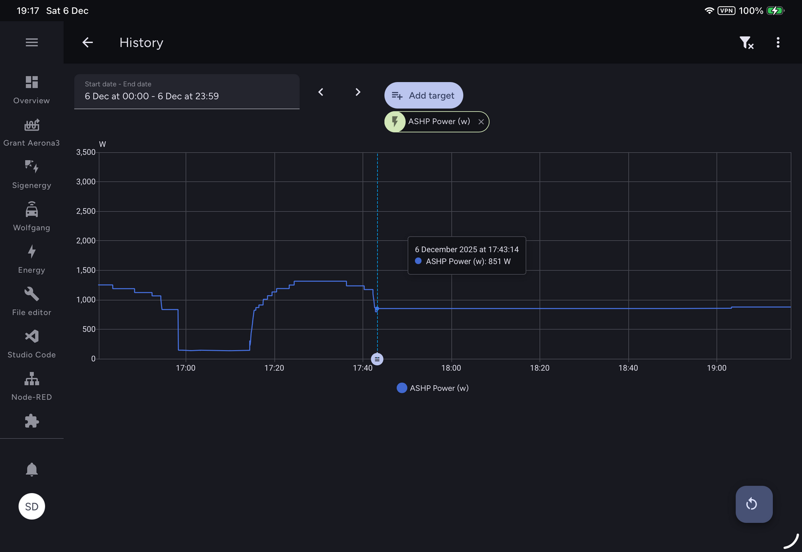

Hold the phone, now I don’t want to jinx this but in the process of balancing my system (or at least trying to) I thought I would go down a different tack and used decorators caps instead of the TRVs (sorry @toodles I failed miserably at following instruction although it is an excellent guide!) I popped out a thermal camera and took a look at all the rads and two were completely off (TRVs were seized closed), no idea why but they are now fully open (obvs checked all the others). All lock shields are now fully open and the three upstairs rads have been closed down via the decorator caps until the rooms were a degree colder than the downstairs. The two massive uprights in the kitchen are set to 2 on their TRVs to offset the Aga now the whole house is at a steady temp every room is within a degree and the best thing yet is I have had a steady run for the past two hours! My COP is through the floor but at 800-ish watts with the compressor at ~30hz I am heating a 4 bedroom 1970s dormer bungalow!
my WC settings are 38@-3c and 26@25c (no idea how I have ended up at these!)

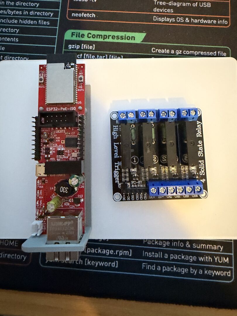

I then really went down a rabbit hole lol with various PoE esp32 controllers (Olimex, LillyGo were strong contenders) and various relay set ups.

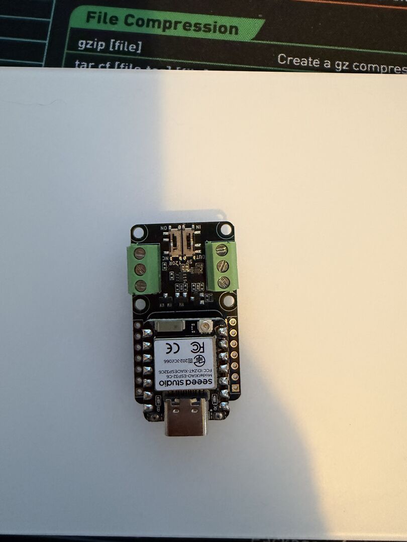

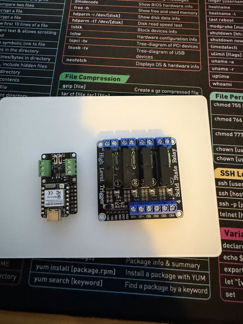

Seeed Studio have an esp32 rs485 addon which is tiny, as long as you have power for a usb c cable and wifi connectivity at your unit you could mount this close to your unit (in a suitable container) and run a short ethernet cable to your unit.
or if you wanted relays add a solid state relay. I have found I only need 4 channels for my set up (DHW on/off, Dual set point, night mode and low tariff mode). that is an apple trackpad for scale.

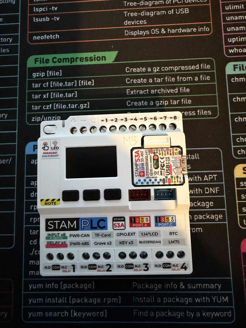

However if you wanted a really simple all in one solution the M5Stack STAMPLC is awesome it is din rail mountable so will fit into a waterproof housing 4 relays built in and also has expansion ports for stuff like external sensors etc.

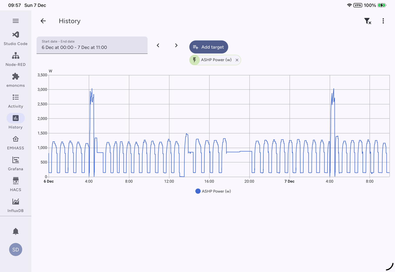

@damonc, when yours is running at 4 degrees and below does the power consumption increase very much from the 700W base level? (I would expect an increase to say 900-1100W)
Mine leaps from 700W and perfect modulation at 6 degrees to 1500 - 1800W at 5 degrees and below. Do you see the same big step change in power consumtion?
Mine then also just fails to modulate below 6 degrees, and after only 8 mins goes over the flow temperature target. Do you see anything like that?
I would almost be happy with your 1.5 to 2 cycles per hour compared to the 6 to 7 that I have below 6 degrees!
To my thinking, if the control system can modulate well at 6 degrees it should be able to do the same at a lower temperature, even though the pump will be running at higher consumption.
Posted by: @steam-poweredTo my thinking, if the control system can modulate well at 6 degrees it should be able to do the same at a lower temperature, even though the pump will be running at higher consumption.
Are you certain that the cycling you see at lower temp isnt just defrost? Below 5 defrost would be expected!
@steam-powered yes about 1-1.2 kw. I’d expect the same I don’t get why it can’t modulate smoothly it’s almost as if it has modulation steps. Maybe something Grant can advise on?
Posted by: @damonc@jamespa that’s possible I guess, is there an automated defrost limit temp?
There is, you cant change it.
Expect regular defrost at any temperature less than 5, until it gets really cold and the air dries out (-5~-10 or less).
You can tell its defrost because
- the fan stops working temporarily
- the flow temperature drops sharply, even to below the return temperature
- at the end of the defrost cycle you will see a (often quite impressive) cloud of water vapour being pushed out the front of the unit
- the compressor will often ramp up to max immediately after in order to recover as soon as possible
Frost builds up on the evaporator fins at the back of the unit and needs to be cleared from time to time. Thats what the defrost cycle does, by robbing a bit of heat from the circulating water to melt the ice.
