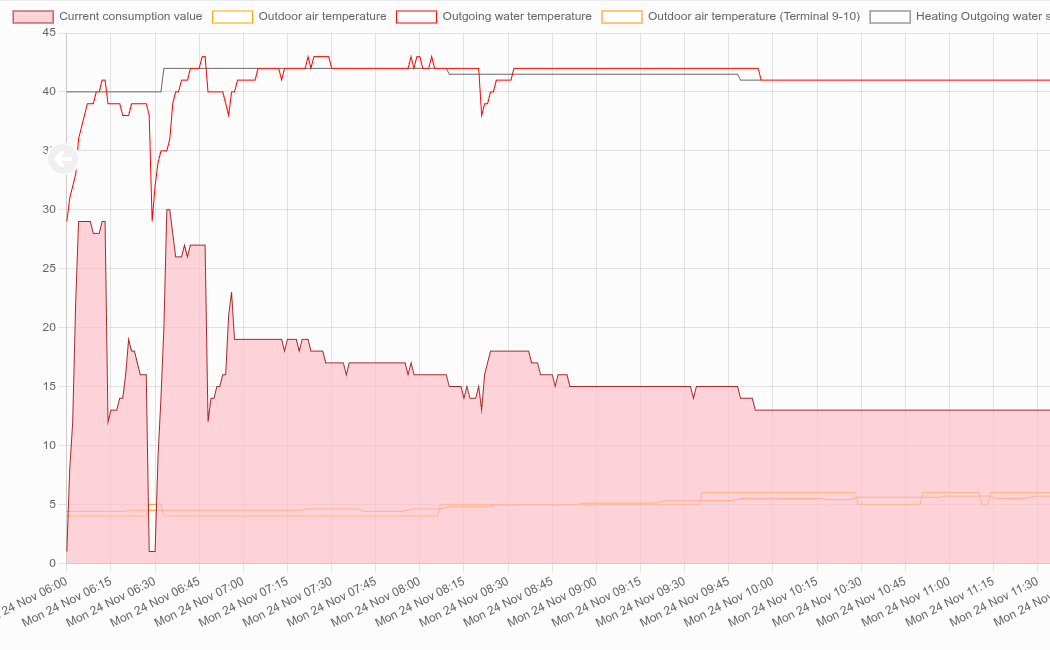

This is what I see at various, recent, outdoor conditions (explanation below each graph):
Screenshot from 2025 11 26 11 05 04
A mild day (OAT around 10C) with "slow and steady" demand, as HPs are happy running. No cycling at all, typical using 700W.

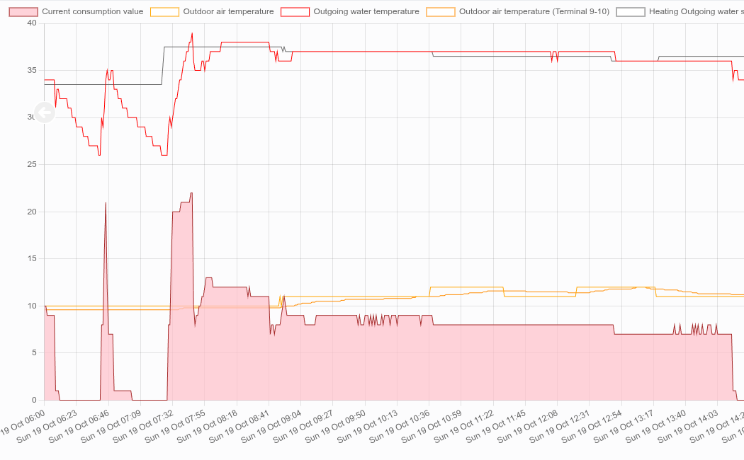

A slightly colder day, around 5C, but again, no cycling, just slightly more energy consumed to hit the higher LWT required.
Screenshot from 2025 11 26 11 07 19

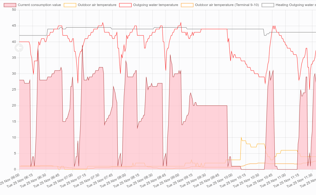

A colder day, just above freezing and the (four) 'dips' in energy usage are caused by defrost cycles. As the day warms, heat demand decreases, and the HP turns off as temperatures are reached. There are then short periods of heating, what I would call typical "boiler cycling" as the temp drops below target, and then goes back above after a 15 minutes from the HP. Not HP "short cycling" just, bursts of heat to keep temps up.

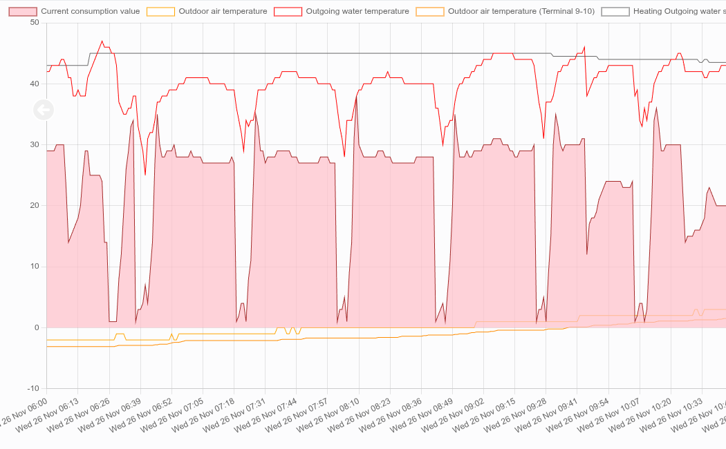

Screenshot from 2025 11 26 11 05 54
This morning - emerging from a sub-zero night, and there are defrost cycles every 40 odd minutes, as HP struggles to hit target LWT. This is typical for my HP in very cold nights, and tends to recover once the daylight arrives.

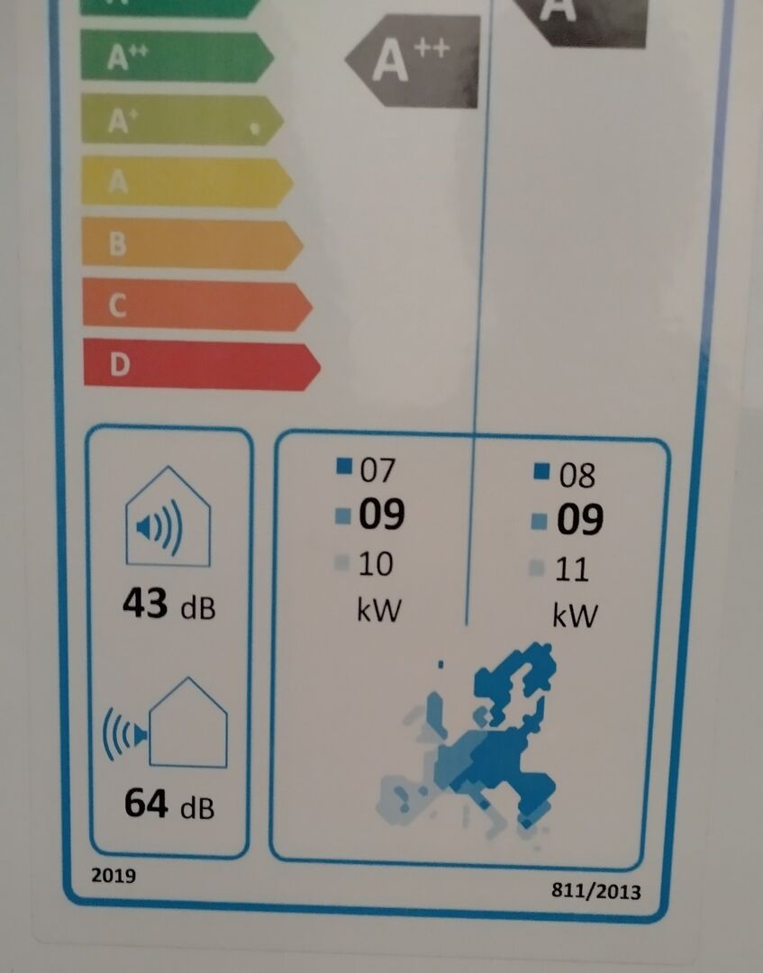

@damonc I was refering to the 'standard' energy sticker that comes with the HP which I think indicates (for my 10kW Grant) that output rating varies by location, and I think I'm in a '9kW' location whereas someone in St Ives or Lisbon would be getting 11kW (for CH):
IMG 20251129 093437
I assume similar stickers come with all HPs (like they do with all white goods in the UK) but it's the sort of thing an installer usually throws away or leaves tucked in pages of manuals, so I guess I was lucky that my installer stuck this on my LLH.

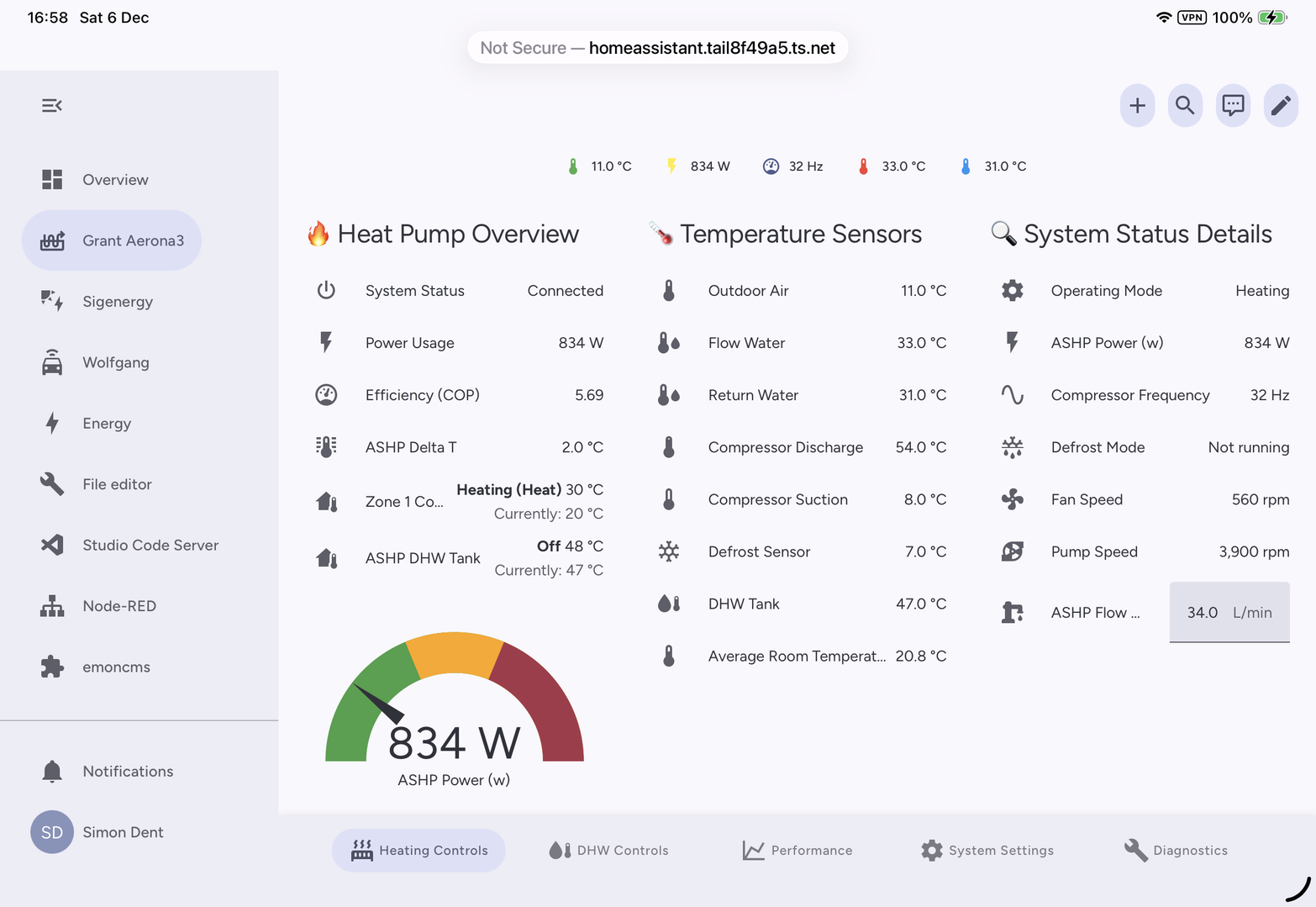

@steam-powered 17kw heat pump for a 8.4kw heat loss is bonkers! I am in a 1970s bungalow with an over calculated heat loss of 11kw (I think it should be 8kw when you move from 2 ACH to a more realistic 0.9). They installed a 13kw Aerona3 and it is definitely oversized. Mine modulates every twenty five minutes or so, but my power usage isn’t too bad usually around 700-1200w but yeah it would be nice to have it just pootle along at an even pace. I am currently experimenting with night mode i.e. restricting the compressor frequency but it rarely goes much over 50hz. I might look at extending my cold end of the WC but one set of tinkering at a time!
For background I use home assistant connected to the ASHP via modbus so I can see everything in real time. I am also completely on rads so no UFH.
