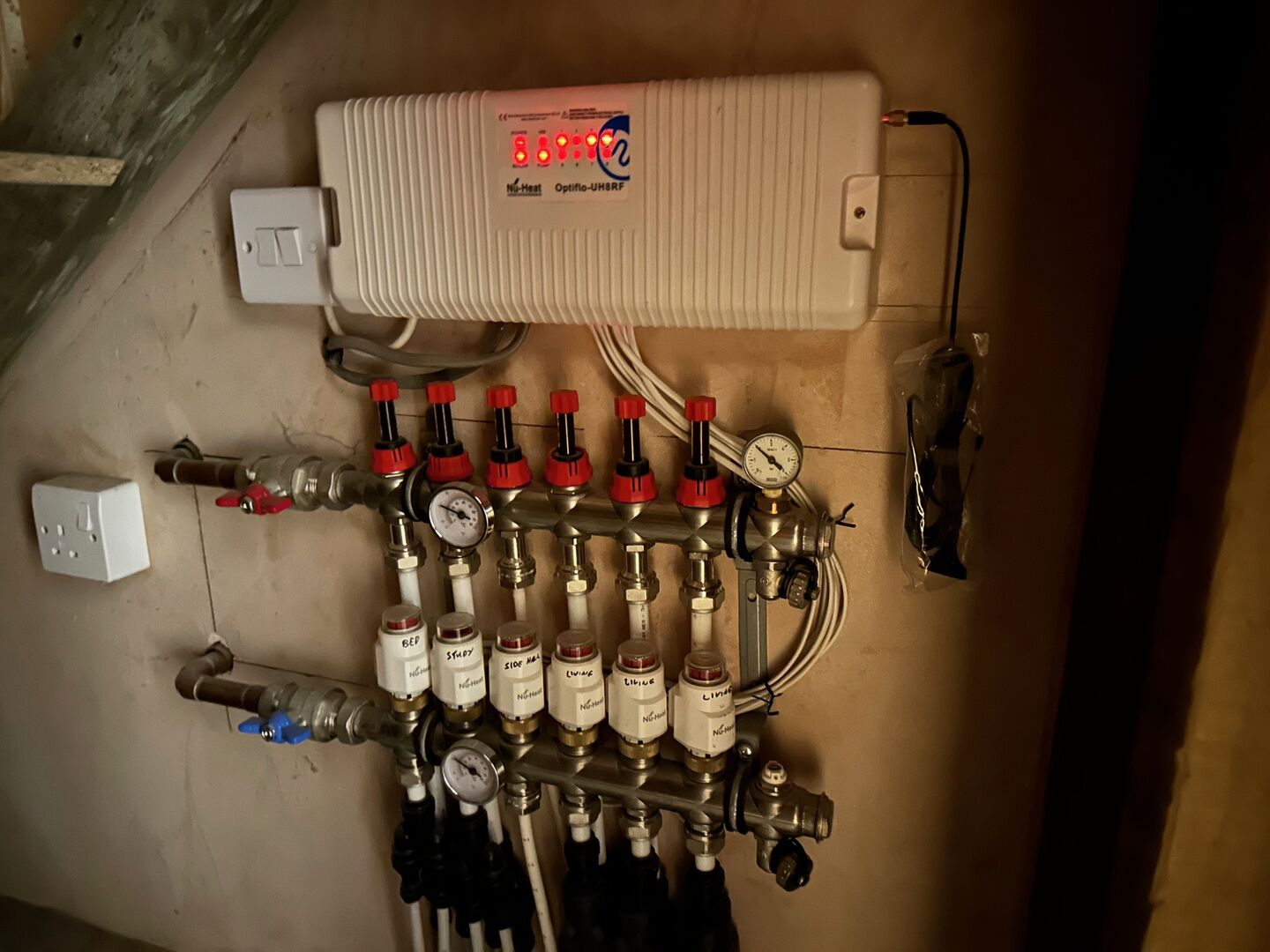

Hey all, read through this and other documents but wanted to get some advice / guidance as struggling to find anyone locally who is familiar with Homely (Huntingdon/Cambridgeshire).
I have a Grant Areona 3 heat pump, so that rules out Tado which I've used in a different house, or Havenwise so looking at Homely.
Currently there is a Heatmeister Neo setup for the downstairs wet UFH and then a Nest which controls upstairs rads and the hot water.
How is best to move to a Homely? I get of course it plugs into the Modbus but I dont understand how then it controls the actuators / valves etc, how the old controllers are removed (if thats needed presumably) etc.
Any help welcome.
Posts: 3463
Hi @vanq  - may I take a step backwards a moment?
I'd like to understand what actuators / valves you have on the UFH manifold.
Any chance of a photo? 😊

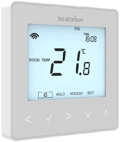

Are these actuators / valves each connected to a Heatmeister Neo wall thermostat like this....?
Or are you saying Heatmeister Neo setup because you've got a Heatmeister hub communicating with several thermostats?
PS Don't worry about using the correct technical terms.
Just describe what you can, and we'll sort it out from there.
This post was modified 12 months ago by Transparent
 Vanq
(@vanq)
Joined: 12 months ago
Posts: 11
@transparent Thanks for the questions.
I've attached a photo of the manifold.  And yes they're all attached to wall thermostats like pictured.  I also have a hub.  The thermostats are battery operated not mains, but have a cable going back to the main area pictured.
