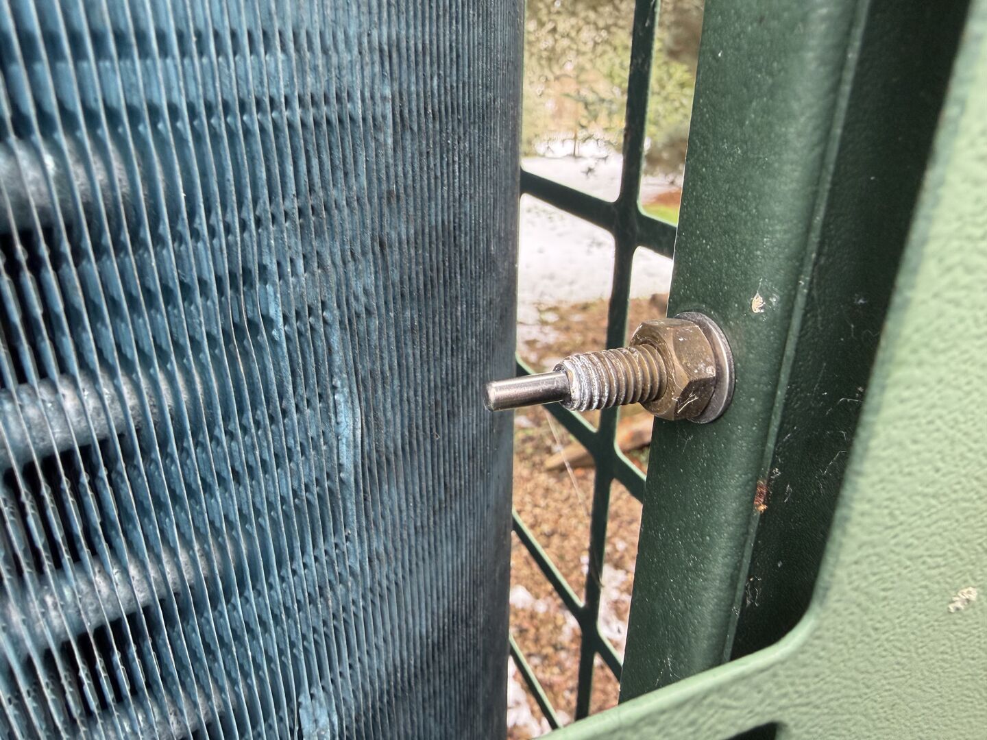

@westkent it’s that black tube that is cable tied over the outside of the rear of the evaporator fins, right?
I have the tube but there’s no sensor RTD  inside it, as far as I understand it.I don’t know if there’s a dongle inside the unit, I don’t want to touch the covers as I’m in dispute with the installers about the fault.
(@westkent)
Posts: 67
It’s fitted to the outside of rear main unit.
if looking from the front of unit it’s top right fixed to the back.
its not a dongle as such but the shape of one.
one screw is used I believe to attach it.
it has one wire fixed to it.

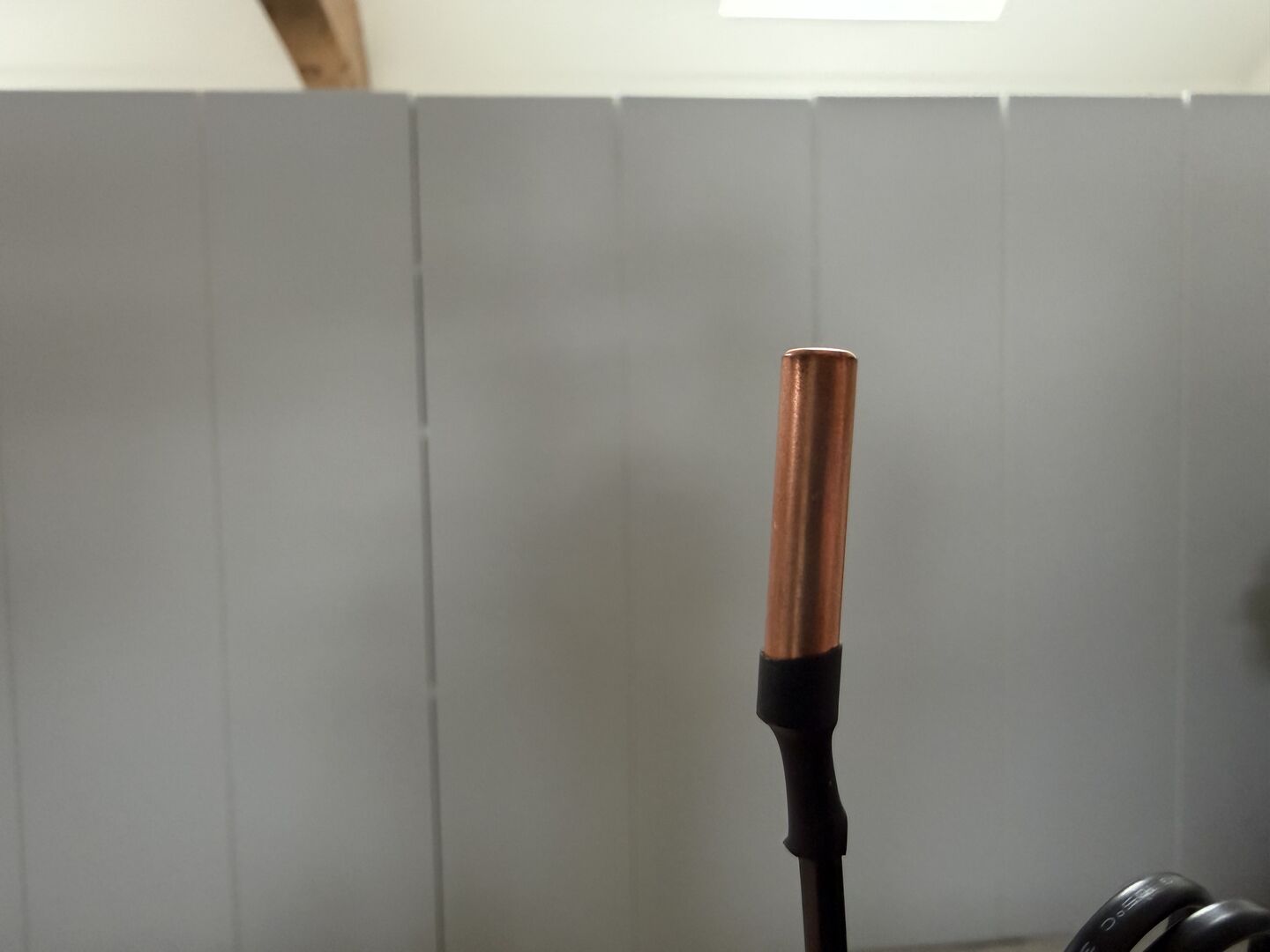

Posts: 5043
Your energy: 57 kWh
Not sure if this helps, but the probes look like this. Ours is mounted into the chassis itself.
IMG 1434
IMG 1435
