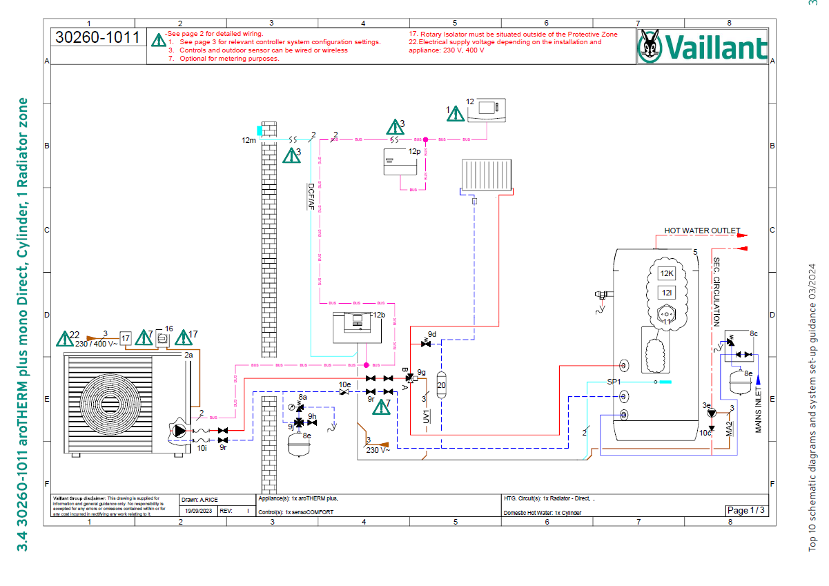

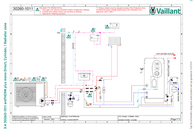

I can see myself complementing my knowledge of an ASHP system in this "estimate evaluation" process... Below is what seems the simplest system (direct) that we could have.
It seems that Vaillant needs to have controls connecting to a HW cylinder. But we could pick the HP HW unit we know will fit the space (and halve the cost in the process) by using the Vaillant VR 10 sensor ...
19k is having a laugh at your expense.  Ignore.

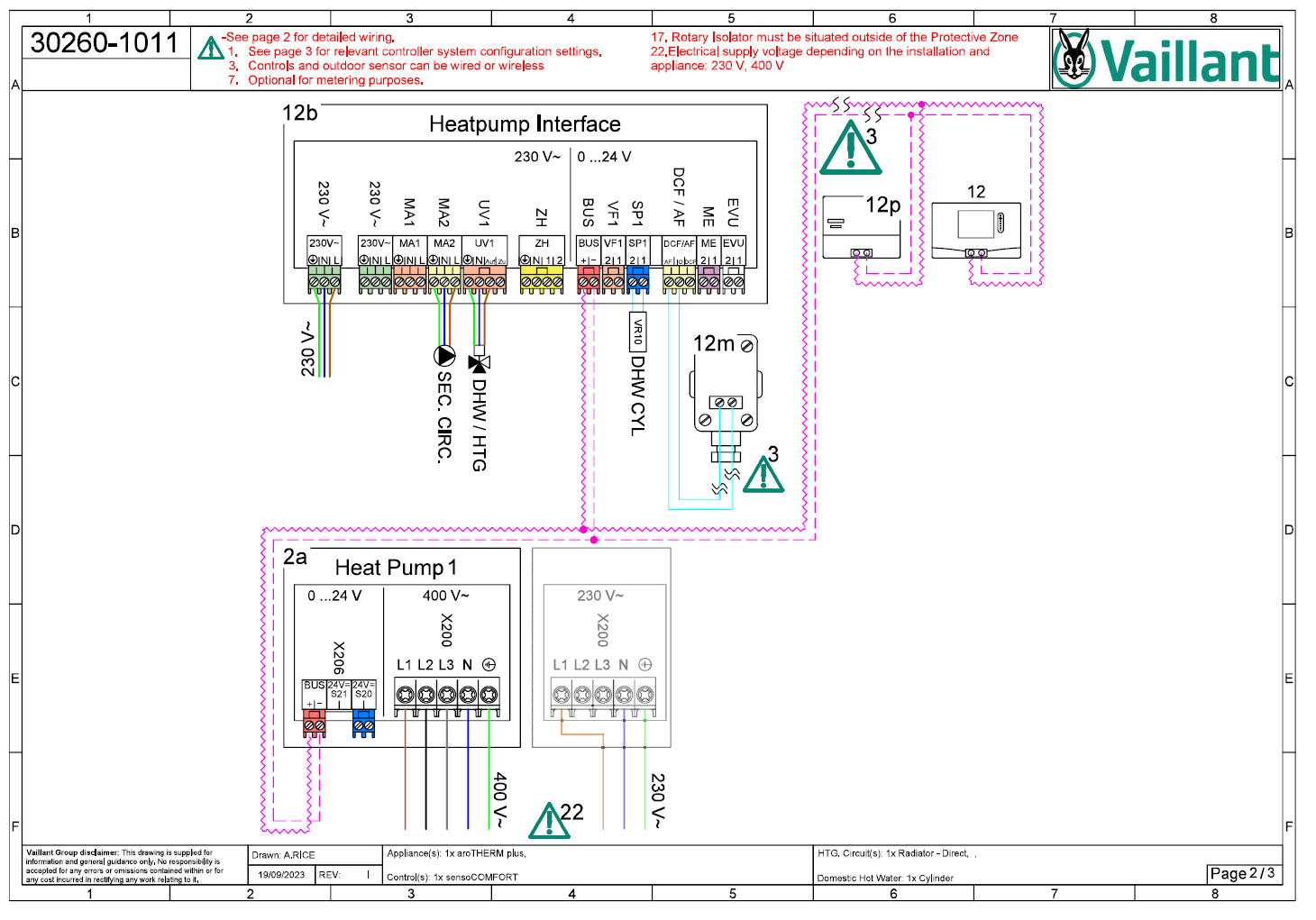

The only connection vaillant need to the dhw tank is a temperature sensor.  Almost all heat pumps need that (and I wouldn't buy one that doesn't), some also need a power control (not needed for vaillant because the legionella cycle is done natively by the heat pump not using any immersion).
It's s 2 wire connection, more ir any cable will do, bellwire, cat 5, mains cable, whatever is kicking around.  I used a piece of 3 core that I happened to have more of than I will ever need in my life.
Obviously the immersion in the dhw tank will need power if you want it as a back up, otherwise don't bother.  Again true for any heat pump.
I think the diagram you show is what I have.
I note that the cylinder is a buffer/cylinder combi which you don't want.
