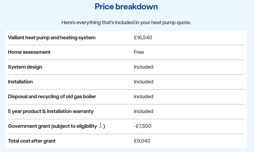

Try British Gas. For me they were by far the most thorough, professional and flexible company ( even compared to Heat Geek).
They'll also happily fit a Valiant HP if you meet the location requirements for R290.
They designed for 42.5c flow @-2 and were more than happy to price match Octopus who were proposing a 50c design, which meant I had substantially increased radiator sizes that will almost certainly allow me to run at 30-35c in most months, probably no more than 35-40c during the coldest weeks.
They listed every piece of equipment to be installed, a complete breakdown including a full power flush, all included and provided a huge document with all the inputs into the heat loss survey, which Octopus refused to give me.
They've also arranged to get our incoming supply upgraded to 100A including replacing the cutout.
Although our install is booked for next year, I have every confidence they'll do a great job.

When I started my journey with BG in October they didn't give me an online quote, perhaps that is a new thing.
After the survey (on the day), the engineer offered me a design choice and I asked for a lower design temperature for maximum efficiency.
The engineer then sat with me for another hour to design the system and produce an exact price.
This entailed replacing every radiator and even adding in another new one. All Stelrad classic compacts.
The best bit when I mentioned our Octopus quote is they happily matched it and knocked a further £3400 off.
Our final price after the grant for a Daikin HP, a 200l cylinder, volumiser and 12 radiators (mostly type 22s and some type 21s) is just over £3000.
They gave me a choice of 4 HPs (Vaillant, Bosch, Samsung and Daikin), although I couldn't have the Valiant due to where I wanted it located.
BG didn't charge me a survey fee, so I'd get them round as the final price is unlikely to be the online quote, depending on your design choice.
