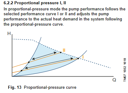

@rhh1 Adding a second pump is not a problem, some units have a control for a second pump as this one does. When you add a second pump, it must either be Delta T controlled or, a new electronically controlled pump (almost all of them are now) set to proportional control. This will boost the flow and pressure within any sysytem, however, you must have some way of confirming the flow rate within the system, without it everything, including heat pump sizing is just a wild guess.

@heacol this may be a silly question, but why would you need a second pump?
The water pump in my Grant Aerona 290 15.5kW is happily pumping the water to the 30 radiators in our house.  The technical specifications say it is capable of 40-50 litres per minute, which sounds pretty high to me.

Posted by: @grahamf
If you do not have enough flow due to small pipes, like Mars's installation, you may need more pressure and flow than the unit can provide. Are you sure that you have sufficient water going to every radiator? In reality, the only way to confirm the correct flow on every radiator is by installing FRV valves, anything else is just a guess.
