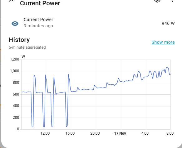

Last night I set the schedule to be 25c 24/7, a temp it can't reach so it is now running continuously. Looking at the sparse data available to me, I can see that I used an average of 1.02kW (min 0.91kW, max 1.17kW) per hour with an OAT between 6.0c and 4.1c, excluding the water heating period. My main living area stayed between 22.2c and 22.4c. A couple of rooms downstairs were at 19.8 at 7am (LSVs on these fully open.) Upstairs temps ranged from 23.7c to 25.5c. I know this isn't wholly relevant but reported COP is 3.91.

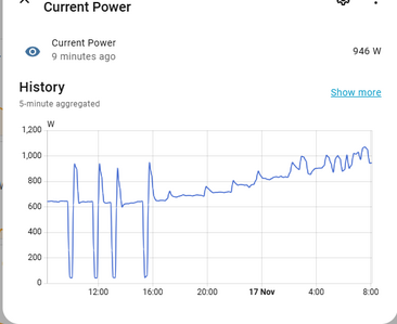

Depending on your house loss and location I would say probably yes.

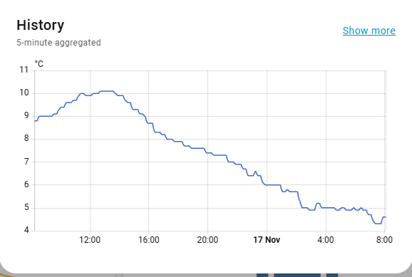

Here is what my 7kW Vaillant has been doing, and the OAT. My house loss is 7kW @-2
